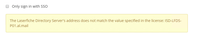

Mobile Config has a section for entering your STS url. It does not say why or what it is for but assuming it is important, since we use STS, I enter the site in there. It says:
"The Directory Server STS does not match the one in license."
Then secretly after I leave the configuration, it removes what I entered and saved.
What is a license?

To clear up some confusion, STS is the service you set up to achieve SSO. If you log in using STS, you are using SSO (aka LFDS authentication).
When it comes to the error you are seeing, this means the STS URL you entered does not match the LFDS URL in the Mobile Server license (which LFDS has generated). This can be a legitimate configuration if your STS instance is on a different machine than the one running LFDS.

As a note, it is expected that the attribute in the license file is a host name: the mobile configuration URL validation checks that the hostname in the license file matches the machine name within the web STS url (it's not trying to compare the whole URL to the host name directly).

replied on October 2, 2019
Ah support gave me a fix. I just have to download the following 2 DLLs manually and add them to the bin folder, then it allows me to save and doesn't warn me about any matching issues.
https://support.laserfiche.com/kb/1014081/list-of-changes-for-the-laserfiche-mobile-server-10-4-1-hotfix-1014081
