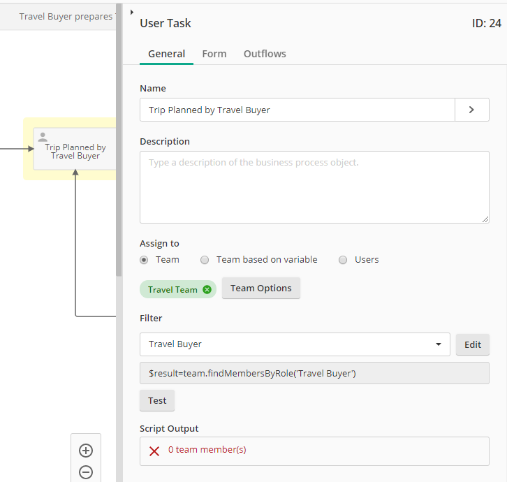

I am trying to assign a user task for a team by using the "find member by role."  However when I test, it does not find the user.  As any one had the issue, or can see what I may be doing wrong?

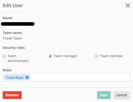

I have the travel team with 4 members in it.  Our "travel buyer" is assigned that role.  I have selected the travel team and used the filter to find a member by their role.
We have Forms Professional 10.4

replied on September 25, 2019
In the User account above, you have assigned the role to the user, but the user is a Manager, not a Member, have you tried also making them a member as well. I believe the Role Filter is only looking at those users who are Members
replied on September 26, 2019
Yes!  Thank you!  It worked.  I would not have thought about it only applying to members, but it clearly says "find member".  I appreciate your help!
