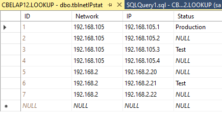

I have a Table in SQL which has columns:
Network
IP
Status

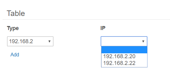

In forms I have a Table, New IP Request
In the table I want that when a user selects Network, the IP column should show available IP's, which should not have Status in the Status column as "Production" or "Test"

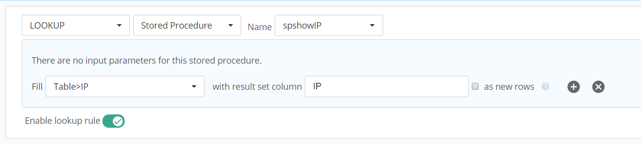

1. SQL Table format
2. Store Procedure
SET ANSI_NULLS ON
GO
SET QUOTED_IDENTIFIER ON
GO
-- Author:          <Mahesh Ramchurn>
CREATE PROCEDURE spshowIP
       -- Add the parameters for the stored procedure here
AS
BEGIN
       -- SET NOCOUNT ON added to prevent extra result sets from
       -- interfering with SELECT statements.
       SET NOCOUNT ON;
    -- Insert statements for procedure here
       select IP from tblnetIPstat where status is null or status = ''
END
GO
3.LOOKUP RULES

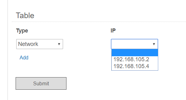

4. Form Preview

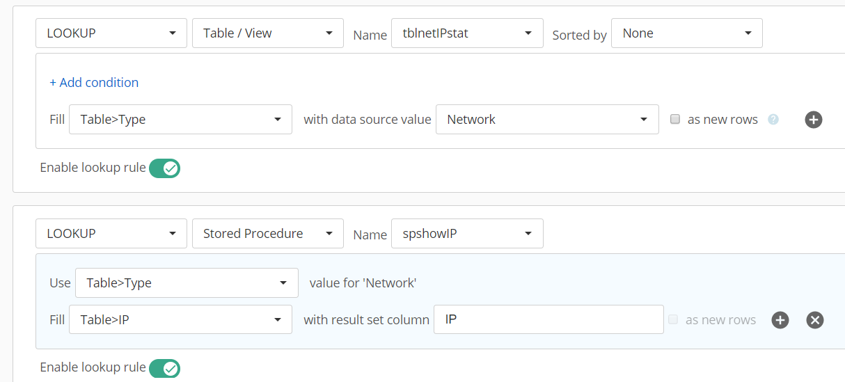

Okay,
You'll have to modify your Store procedure to pass the variable for the network and it should give you the expected result.
Use this SP  below instead, amend where applicable.

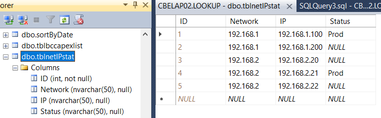

replied on September 16, 2019
Sorry Mahesh,
one thing i noticed, in my column Network, the values are the first 3 octates of IP
So if the IP is: 192.168.2.10
Network is: 192.168.2
Based on the selection of Network range the available IP's which are not Test or Production should be shown...
