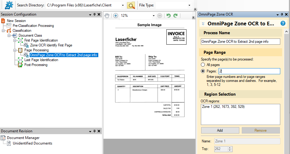

2. set Zone OCR to extract the 2nd page.

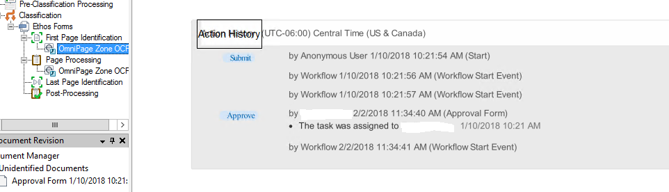

I set up the Zone OCR process under First Page Identification and that seems to work just fine.

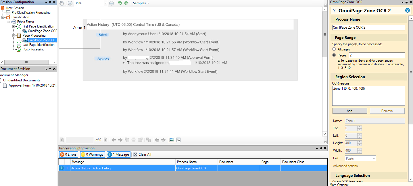

Then I click on Page Processing and add Zone OCR and set the Page Range to 2, but I still have the sample page of the first page.  So I can't align the scanning zone.

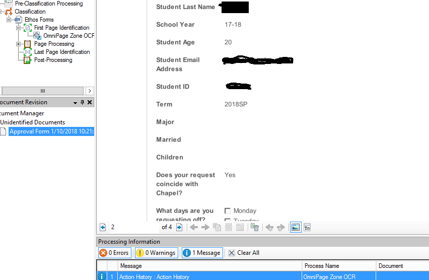

I need to select the Student ID from the second page which looks like this...

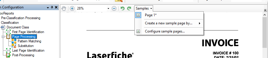

When I click the link to Add sample page, it adds the first page again.  I have tried that...many times actually.  laugh  I always end up with multiple pages that are all copies of the first page.
I have verified that it actually did identify 4 pages and that they are the correct pages from the document...
...but all of the samples are the same.
