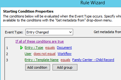

I setup a workflow with a starting rule for Entry Changed. But whenever someone Deletes an Entry it triggers a change, which causes workflow to throw an error in the event log that it can't find the entry to start the workflow on.
How do you state on Entry Changed but NOT Deleted?

I have a customer that is getting a bunch of terminated workflows every day and this is the same issue as above. They have a starting rule for the "Change" event, with some generic rules which look fine. We looked at Audit Trail and there was NO changes done to the entry around this time, only a delete event and we noticed that the workflow is triggered at the exact same time to the millisecond.
The message is "Entry not found". The workflow is triggering by the "Change" starting rule.
Is there a way we can restrict the starting rule from triggering upon a delete? I noticed there are options for when pages, tags or templates are deleted, but not actual entries.

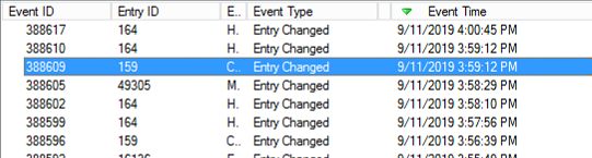

Did you look in the Subscriber Trace to confirm there were no entry change events before the deletion? Did you confirm there are no starting rules for entry deletion?
replied on September 11, 2019 • Show version history
It is never listed in the subscriber trace, likely because we have no rules with a condition for Entry Deleted.

There are only 2 logs in the trace at that time and neither for this entry.

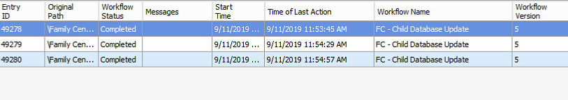

Just to be clear this is not an "Entry not Found" as part of a workflow that is in process, when a user deleted the entry. The errors are being sent from the subscriber and there is no actions taking place with this workflow past 11:55AM.
