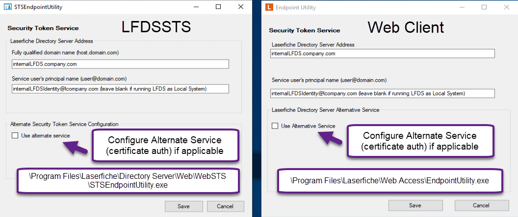

For the second scenario, an infinite redirect between STS and Web Client usually means that Web Client is not accepting the STS auth token and kicking you back to STS. STS thinks you have a valid auth token and sends you back to Web Client. And so it repeats.
Can you verify that the DMZ STS instance is configured to meet all requirements specified here?:
https://www.laserfiche.com/support/webhelp/Laserfiche/10/en-US/administration/#../Subsystems/LFDS/Content/separate-sts.htm
Then, run the DMZ Web Client's endpoint utility to verify it is configured correctly as well.
Cheers,
Sam

replied on April 8, 2022
  1. You're pointing the DMZ Forms instance at the DMZ STS instance for the auth redirect?
  2. The DMZ STS instance isn't throwing any errors in the event log?
  3. the DMZ Forms instance isn't throwing any errors in the event log?

1. Correct DMZ WebSTS points to their FQDN of the LFDS Server, but they are using the Alternate Service token, pointing to a WC SSL Cert that is not being used on the LFDS Server.  I am wondering if that is the issue.
2. DMS WebSTS event log only throws the following (last date stamps is 2.24.22)Access to the path 'C:\ProgramData\Laserfiche\LFDS\STSConfig.config' is denied.
This customer has not tried to log into the External Forms site, since sometime in 2021, so this error could be relevant, if there was some permission change, I guess
3. Nothing showing in this log from the internal server.
Appreciate your feedback,
Jeff Curtis
replied on April 12, 2022
Hey Jeff,
  1. The DMZ WebSTS Alternative service is likely not configured in a working manner right now. That would be an issue.
  2. That likely implies that the DMZ WebSTS is running as a custom service account instead of the default Network Service account. Change the IIS LicenseManagerSTSAppPool identity back to Network Service. It definitely means the DMZ WebSTS isn't working right now.
  3. There wouldn't be any errors on the internal service side since the broken DMZ WebSTS likely isn't able to send messages to the internal server at all.
