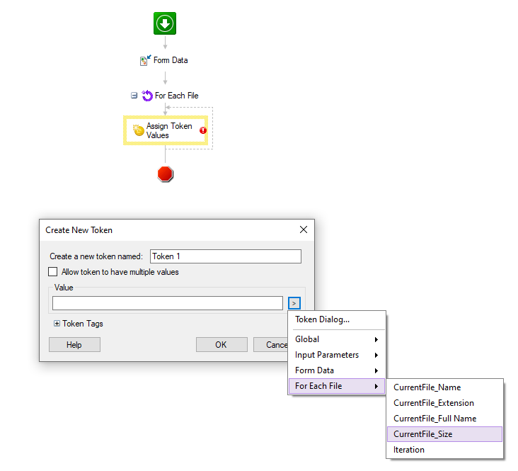

In the workflow, just retrieve the "File Upload" variable using the Retrieve Business Process Variables activity.
Then, you can add a For Each File loop and the file size will be available right three as a token.
This method will be a lot more reliable than using JavaScript since JavaScript is client-side and can be impacted by the user's browser/behavior.

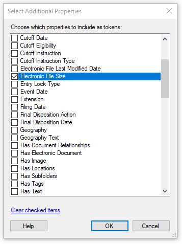

Additionally, once the files are saved to the repository, the size can be retrieved from the Electronic File Size property/token of the entry, so depending on your process you might not even need the For Each File loop.
replied on July 28, 2022
thank you for the information Jason, As the files are store in Laserfiche already. I am adding the "Electronic File Size" property of each file.
However I am not getting the correct file size. Do you the format of the Electronic File Size? Is this KB, MB. Should I use an integer or number type for the token?

@████████ You're probably not getting the wrong size.
The Electronic File Size is stored/returned in bytes since KB, MB, etc. are really only used for display purposes.
What's worth noting is that Windows and most other environments calculate these in increments of 1024 not 1000 (i.e., 1 kilobyte = 1024 bytes)
So a 2KB file would be 2048 bytes (1024 * 2)
A 2MB file would be 2097152 bytes (1024 * 1024 * 2)
And so on
If by type you mean Tags, those really only matter for conditional evaluations, but number and/or long integer would be fine (you can choose more than one, just uncheck String).
