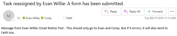

In forms we utilize the teams tools, assigning a task to a team and then filtering to assign to a role.  Occasionally users will reassign the task back to the entire team (for various reasons.)  When they reassign the task, selecting the team, it correctly shows the number of people in the team.
However, when the team task notification sends, it is sending the email to all members of the team, plus all those who have ever been in the team.  When I did this test reassign to the Test Team, it sent the email notice to myself and Corey, the two in the test team, as well as Faith, who is no longer on the team.

Thanks for the answer and the SQL script Jason.  It does look like the 'leave_date' value is getting properly set.  So like you said, whatever is pulling the names of the members isn't looking at the leave value like it should.
I'll go ahead and contact my VAR for the next step in submitting a bug report.
One more detail I don't think I made very clear from the initial post, is that initial task assignments are working perfectly fine.  It is only on the reassign step that we are having this.

replied on August 27, 2019
I did the additional test by assigning to the entire test team (no filters) and it properly assigned to only the two people.  (Myself and Corey.)
It seems that it is the reassignment process that is having the issue.
