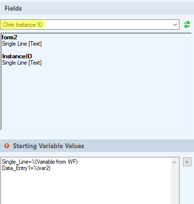

You could retrieve Metadata from the template in the workflow or set from a DB look up, then set business process variables as this can launch forms from WF/BP, with the variables passed using this method, you can reference the Fields on your forms with the variables in your WF/BP. This will pre-populate the information on the form.
I have added a quick example on how to use this, the highlighted area is the Form.
First you add the form Variables, then you add your WF/BP Variables.

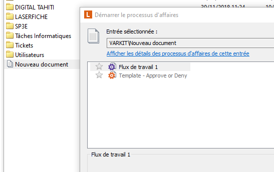

I tried to run "Flux de travail 1" but nothing.
