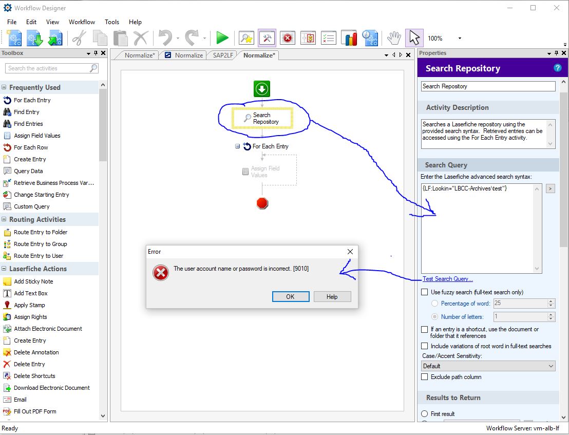

I am trying to do a repository search in the "test" folder and when I run the "Test Search Query" I get this error.
It appears no matter which folder that I am looking at.
Any suggestions?

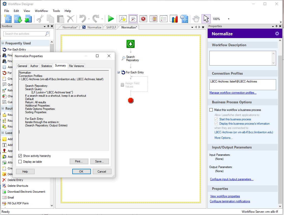

Error from last post (Capture2.jpg)
From the workflow properties (Capture1.jpg)
Normalize:
Connection Profiles:
• LBCC-Archives (vm-alb-lf.lbcc.linnbenton.edu; LBCC-Archives; listerf)
        Search Repository:
        Search Query:
                {LF:Lookin="LBCC-Archives\test"}
        If a search result is a shortcut, keep it as a shortcut
        Default
        Return: All results
        Additional Properties:
        Fields Options Properties:
        Sorting Properties:
        For Each Entry:
        Iterate through the entries in:
        (Search Repository::Output Entries)
replied on October 25, 2019
The error message is telling you that there is a problem with the connection profile for the workflow so it can't connect to the repository at all.
How do I change the user?
We recently switched to Active Directory and everyone's usernames changed.
When you click the whitespace of the workflow area, on the right side under the Name and Description is the connection profile section.
Click "Manage Connection Profiles" select the profile and you can edit the password. Just be sure to validate it before saving any changes.
