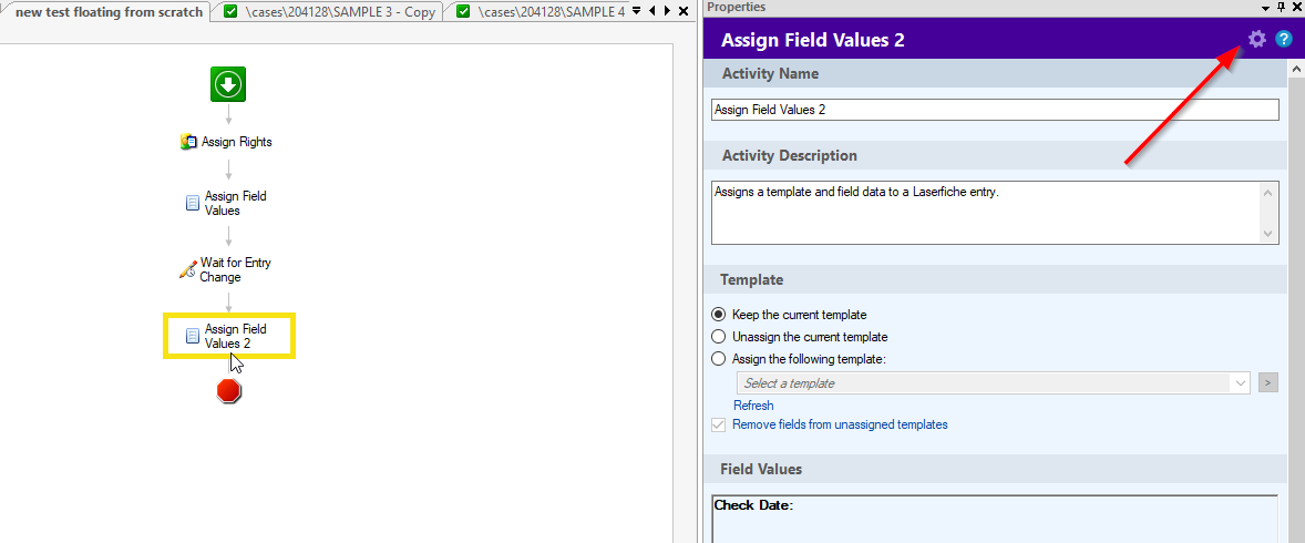

This was identified as a change in feature introduced by Laserfiche in Workflow 10.4.1.
This issue does not present itself when doing a clean install of WF 10.4.1, but results when upgrading to WF 10.4.1 from previous versions. This issue also only applies to newly-created "Assign Field Values" activities AFTER upgrading (previously-existing field removals will still work after upgrading).
To correct this issue, when creating an "Assign Field Values" activity to remove a field ("Keep Current Template" option and specifying the field with a blank value), then go into the Advanced Options of that activity (gear icon in upper-right corner of Properties pane when that activity is selected).
In the Advanced Options view, there will be a checkbox for "Override default values when setting blank field values"; you must UNcheck that box, then republish your Workflow.
Remember to republish the Workflow, as it will not register it as a change and prompt you to republish before running.
This should correct the issue and allow the specified field to be removed from the metadata.

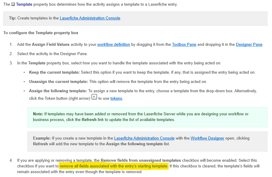

You can remove non-template fields from an entry by setting them with blank values in the workflow. The first approach you listed should be correct. What was it not doing that you wanted?
The "remove fields from unassigned template" option does not remove all non-template fields, it only removes the fields that were associated with the previous template, assuming they are not part of the new template (the key word there is the "unassigned" template).

To answer your question, all I do to clear the values is the same thing you showed in item 1. I set them equal to blank values and keep the current template.
The second step won't change anything because you're keeping the same template and the checkbox only applies if a different template is assigned.

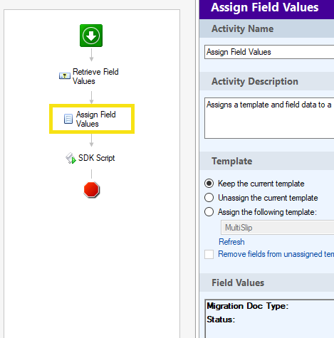

I believe that ever since Laserfiche has allowed blank independent fields on entries, workflow has functioned as Chris is stating; the document keeps the field assigned with a blank value.
The only way I know of to remove the blank independent fields is to use an SDK script activity.  So use the Assign Field Values activity to clear the values and then use a SDK Script activity to remove the blank independent fields.

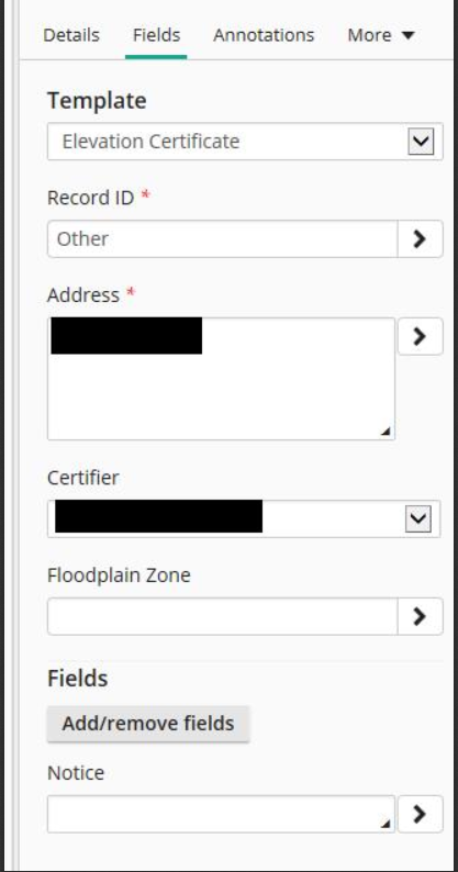

replied on August 23, 2019
Hi all,
I have just upgraded from 10.3 to workflow and server 10.4.1 and i am having the same issue. i had started a workflow prior to the upgrade and I am trying to finish it now. All the approval fields I added prior to the upgrade are still working as usual: once workflow clears the field, it no longer display in the fields tab. However all the new fields I added after the upgrade, once cleared are still displayed.
In the picture below, the field Notice (added to the workflow after the upgrade) should not be showing blank but should have been removed  from the fields tab. This document was processed and two other fields were added and removed through the approval process via the assign fields activity (fields were added to the workflow before the upgrade).
replied on September 2, 2020 • Show version history
I'm having the same issue; un-checking the indicated checkbox does not work for me.
The supplied solution by Dustin Forster works to remove the empty Fields without using a SDK script activity.
You must remember to publish a new copy of your Workflow, replacing the current copy, after making that change.
Workflow will not automatically register the un-checking of that box as a change, and will not prompt you to publish your changes before closing the Workflow. However, you must manually re-publish your Workflow for the changes to take effect.

Here is the code I used in a SDK Script activity to remove any blank independent fields:
            ' Lock the Entry for modification
            BoundEntryInfo.Lock(LockType.Exclusive)
            Try
                ' Create a list to hold field names to remove
                Dim lstRemove As List(Of String) = New List(Of String)
                ' Get the collection of Fields from the entry
                Dim fvc As FieldValueCollection = BoundEntryInfo.GetFieldValues()
                ' Check each field
                For Each sField As String In fvc.FieldNames
                    ' Check if value is null
                    If fvc.Item(sField) Is Nothing Then
                        ' Only remove independent fields
                        If fvc.IsIndependent(sField) Then
                            ' Add Field name to remove
                            lstRemove.Add(sField)
                        End If
                    End If
                Next
                ' Process list to remove
                For Each sField As String In lstRemove
                    ' Remove each field in list
                    fvc.Remove(sField)
                Next
                ' Write changes to entry
                BoundEntryInfo.SetFieldValues(fvc)
                ' Save changes
                BoundEntryInfo.Save()
            Catch ex As Exception
                ' Report error to Workflow
                WorkflowApi.TrackError(ex.Message)
            End Try
            ' Unlock Entry
            BoundEntryInfo.Unlock()
4 0
