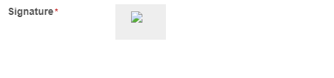

We don't have Adobe Reader installed, I believe Laserfiche uses their own DLL. I have found that it happens when someone enters their own string into the Signature field, replacing the base64 code. Since the string they entered (usually their name or just a single letter) is not a valid code to generate an image out of the PDF generator can not generate a TIFF. I just can't figure out how they are doing this, likely by using an alternative browser that gives them additional access.
Here is an example where the user replaced the Base64 code with just the letter A
And it looks like this when trying to view the signed form

Did you ever figure out what causes this?  I've got a business process with multiple forms, all with signatures.  The user signed all of the forms, but the process suspends on "Save to Repository" for all but one of the forms.  The suspended "Save to Repository" forms all generate this error
The PDF generator was unable to contact the Laserfiche Forms server. Please ensure your SSL settings are correct. [LFF4112-PdfNetworkError]
On the Monitor page, one of the forms shows a signature, however, all of the other forms just show the generic graphic and no signature.
