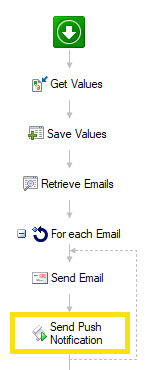

All start with a simple Workflow
Next, in the mobile app, get the notification.
Next, when the user click on the notification, run the Laserfiche Mobile App to the right form.
I know we can do like this with a form process but now is it possible to start with a workflow?

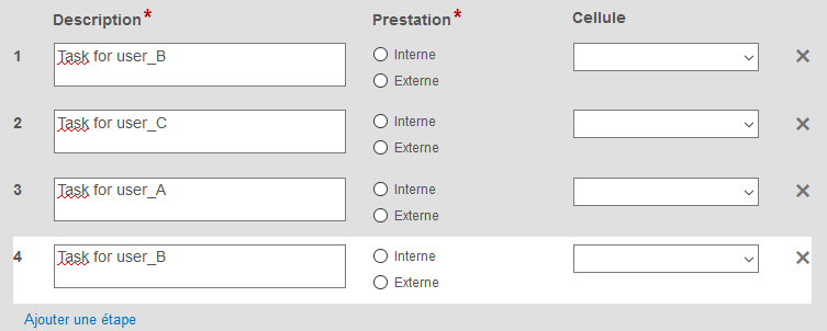

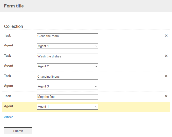

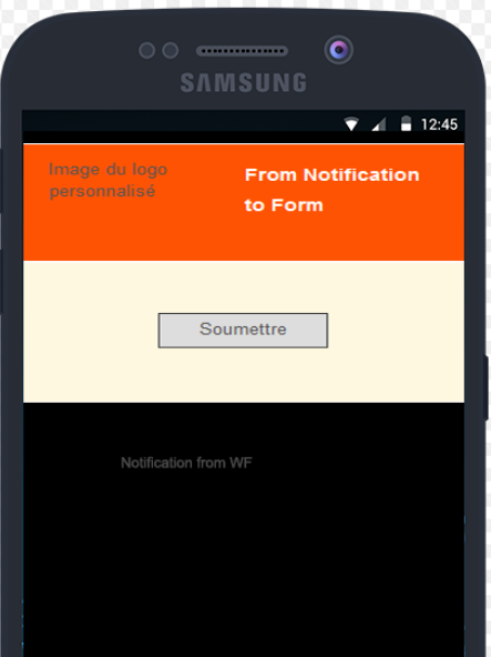

This is my scenario.
From Web Form, using a collection, User_A can create tasks for different people (user_A [himself], user_B, user_C,..).
Each user can have 1 or more tasks.
At the submiting, using a Workflow, each task created is saved in a database and an email is sent to the users to warn them that they have a stain. On the email, I insered the links to the next Forms.
I wish to change the alert because each users need to open an email manager to know if they had get the emails.
I wish to add a push notification on the Mobile App to alert the users and redirect them to the next forms.
Like this, from there smartphone, each users can just click on the push notification to open the forms.
Next, using Workflow and schedule, if a task is still OPEN in the database, I wish to alert 1 more time the user by email and push notification.
Let me know if this is not pretty clear.

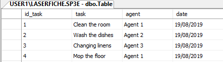

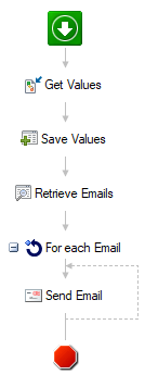

This is my first process.

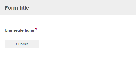

And my Form
When the Submit button is clicked, my workflow is starting.
The values are saved in the database.
And an email is sent to the agents.

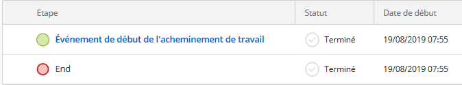

replied on August 19, 2019
Why not have Workflow start the Forms process for them and assign the task? That way you'd get the notification in the mobile app.

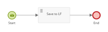

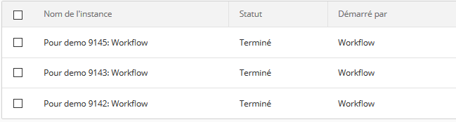

Hi Miruna,
I tried to start the process from the workflow but it didn't work.
I means my process start and end immediatly and I didn't receive the push notification.
I inserted a required field to force the form but nothing. The process started and end

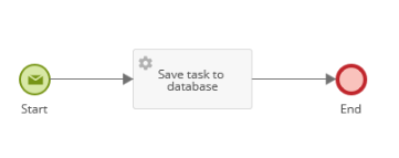

This is my process.
What was the terminating error in this Forms process?
But, since this is where you are going to give those tasks to users, shouldn't you have a User Task action instead of a Save to Laserfiche one?

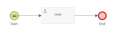

My bad! I thougt I could start with the green one.
So I should start like this, right?

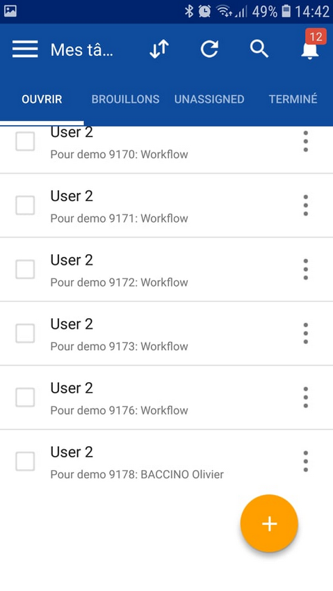

Ok, now my process is started.
On my device, I received the task but not the notification.
On my settings, notification is "on".

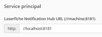

Did you configure notifications in Forms?
Miruna,
Under Laserfiche FormsConfig#notification, the url is filled.
I tried "localhost", pcname, ipadresse but nothing. I don't have the notification.
replied on August 19, 2019 • Show version history
Hi Olivier,
Please see if other forms are getting their usual notifications. We are in the process of renewing the notification certificate. Windows platform is cleared, and we are resolving a couple of cases for the iOS and Android platforms as we speak.
If you see the same issue with other forms on iOS or Android, it's possibly due to the old certificate issue. It's a good sign that you are getting the tasks.

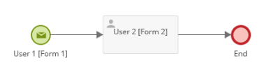

I tried a simple process with 2 participants (without workflow, only LFForms).
User 1 (me) started the process using the Form 1,
Next, the user 2 (a colleague) should get the notification to continue the process with the Form 2, right?
Under his Mobile App, he get the task but he didn't receive the notification.
replied on August 20, 2019
The notification bell shows 12 new notifications. Is none of those for the form you sent?
Miruna,
The 12 notifications from notification bell is all for my new form I sent but I didn't receive the push notification.
I means, I need to open the Mobile App to see the notifications. In my home screen I don't have the notifications.
replied on August 21, 2019
Actually, the team working on the mobile app tells me we currently have a bug in the app that prevents push notifications from working on iOS and Android devices if TLS 1.0 is disabled on the Forms server. We're looking into issuing a patch.
The functionality should still work in the mobile app on Windows 10 if you just want to see it in action.

replied on August 12, 2019
Hi Olivier,
The notification service currently supports the cases when a form process causes changes in a user's task inbox. If the workflow in your example doesn't touch this particular function area, notification is not yet available.
That said, we are constantly looking into updating/upgrading our services to meet new needs, and would like to understand better what kind of use cases you are trying to solve. As a mere speculation i have, are you trying to send mobile notifications when certain repository documents, or metadata etc, have been updated, where currently you can configure the WF to send out an email, or something along that line? I don't want to speculate too much and wild at this point. Your feedback will help greatly to improve the LF App.
