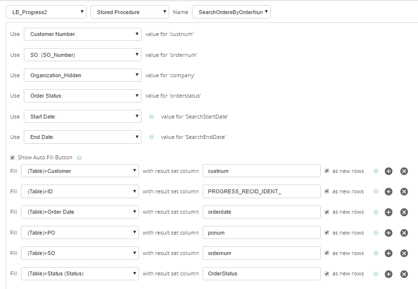

 I am using Forms 10.3.0.975.  I have a stored procedure that is set to run whenever the autofill button is clicked, however I can 100% replicate that if the stored procedure is in place, it causes the form initial load time to increase to more than 2 minutes.  Does forms run the configured stored procedures on load for some reason?
The procedure is attached below.  It uses dynamic sql to search a table for records.  This is done because they may check one of several options to search by and it didn't make sense to create separate stored procedures for every single search combination.  They will also be adding 4 additional criteria, so it becomes an exponential number of possible combinations.

I have had this problem recently, this could be down to a le fields from sql althoarge amount of data being returned and the page takes a while to render all of data although, this should not take quite 2 minutes! Does the stored procedure when run directly from SQL take anywhere near this amount of time? If not it could be possible that either something the lookup is returning may be pointing to additional lookups which is causing a lookup loop which will continue until it has looped through every returned row... which could easily take this amount of time. Or something within the javascript code is being looped on every change to the table... maybe formatting the table after every change for example.
