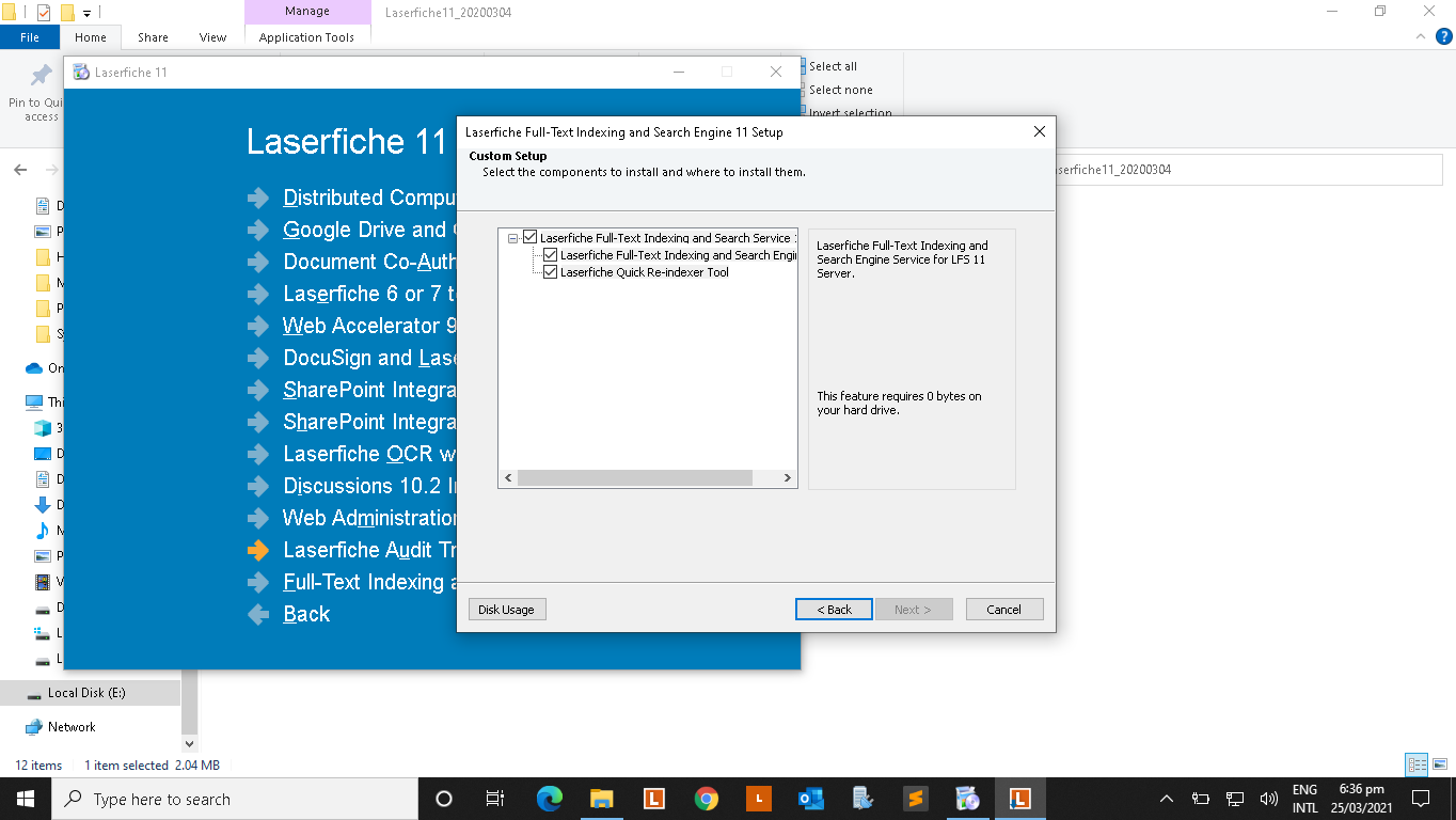

replied on March 25, 2021
Hi Chris,
Please see this attachment, I already updated our var laptop but I don't see the option as you said.
Thanks
Hey Rafael,
It isn't an option on every version upgrade, only when required, I'm not exactly sure on when it's required, I haven't seen it for a few versions now, Laserfiche might have to offer some insight into when the LFFTS requires upgrading between which versions.

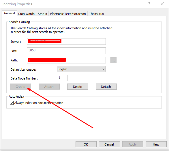

replied on October 18, 2019
Ah ok, sounds like you've hit something a bit more complex than what we can discuss on an open forum. I would suggest either re-creating your text catalogue as a quick fix, or opening a case with Laserfiche support and they can troubleshoot this further with you.
replied on October 18, 2019 • Show version history
how to re-create the search catalog or  text catalog?
Click create here instead of attach.
Then click yes when prompted to start a re-index.
What about may previous search folder where the search catalog is in, can i transfer it?
The search catalog can completely re-generate, you can re-create the whole thing from scratch as it uses the LF volumes to re-build the catalog. I would go for a re-index (re-create) if you're having issues with attach and detach. There is a helpful guide here if you are looking for something step by step. https://support.laserfiche.com/kb/1011970/regenerating-a-repositorys-search-idx-files
