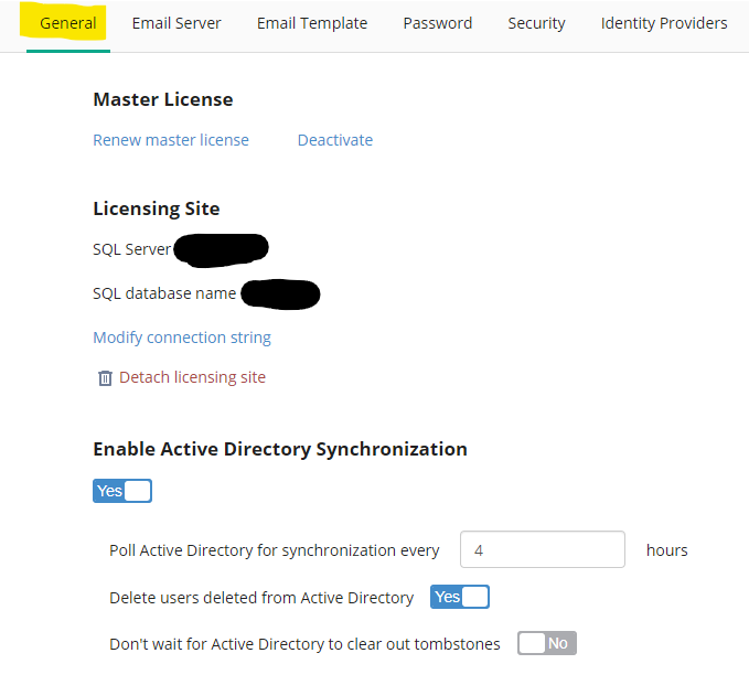

You can configure your AD domain controller(s) as an Identity Provider.
Then you can configure the synchronization on the main Settings page

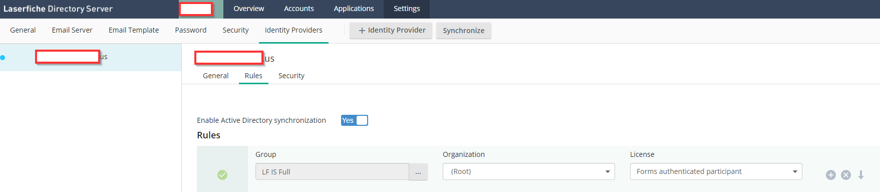

What setting page looks different? The screenshot you posted is the Rules configuration page, which is something different.
What do you see under the "General" tab, which is where you set up the identity provider(s)?

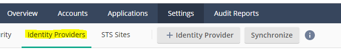

Also, at the top of the page, there should be an "i" button next to the Synchronize button. If you click that, it will tell you the results of the last sync attempt.

Hi Jason,
This is what I am seeing under General Tabs.

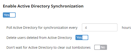

Did you enable AD synchronization on the General tab? This is separate from configuring the Identity Providers (my first post has two separate screenshots).
replied on July 23, 2019
Yes, we have that option enabled.

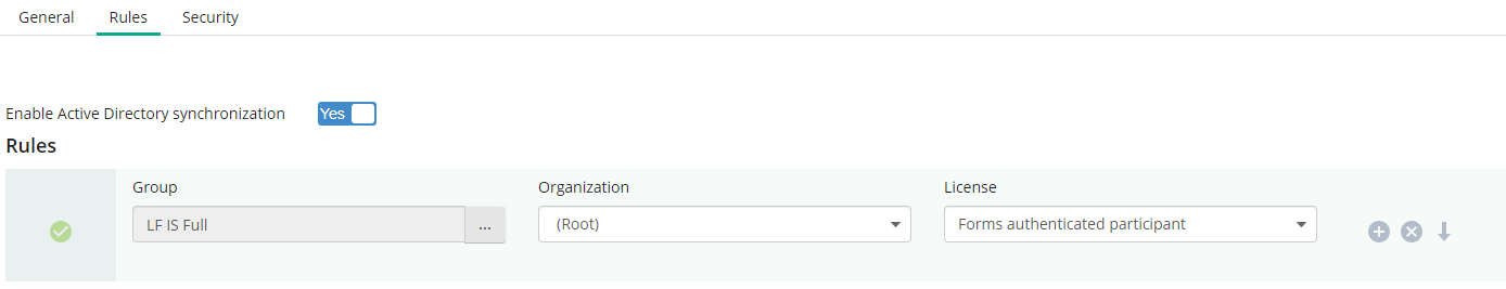

That's not the same page. The screenshot is still showing the Identity Providers > Rules page, which is only applying AD sync to the licensing rules.
You need to look at the AD synchronization settings on the main General settings page, which is the "General" link directly below where it says "Laserfiche Directory Server"

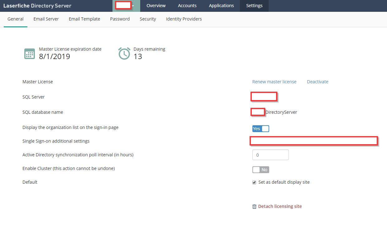

I see what you meant. This is what I have under General
replied on July 23, 2019 Show version history
Interesting. It has been a while since I worked with 10.0, and it looks like they moved a lot around since then so Miruna will probably be able to provide better assistance.
I would have thought it would still be there or under Identity Providers > General.

What happens when you hit the "Synchronize" button to try manually initiating the synchronization?
Note that in 10.0, you need to perform a browser refresh before the users will appear:
If the users still have not synchronized, you can check for errors in the event log under Application Logs > Directory Server > Server > Admin.
The most common reason for failure is insufficient licenses, so you could perform a test with a much smaller group first to (1) determine whether the issue is insufficient licenses and (2) to more quickly troubleshoot since the sync will finish faster.
