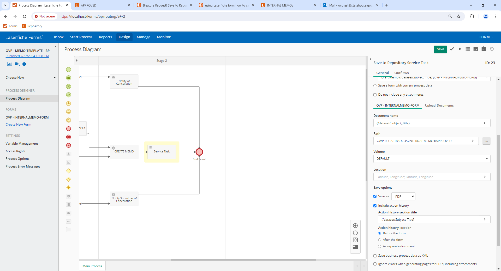

I have just configured my form to save form attachments to repository but it  is not save the attachments to the deisgnated folder using the Save To Repository User Task .
Am I doing anything wrong?
Also if you noticed, the business Process diagram, i placed the User Task after the Workflow Service Task that should create a document from the submitted form.

Hi Adeyemi,
The configuration page you show here is for the form, but not attachments, you can configure the paths there in the "Upload_Documents" tab, which should be able to save attachments to desired paths.

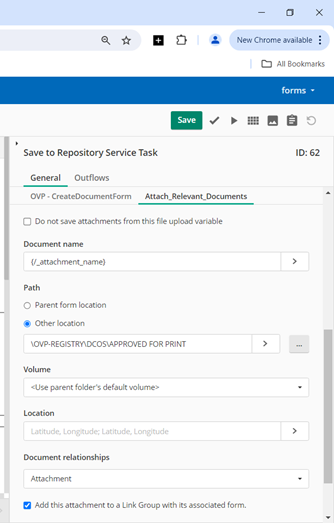

I actually configured the save to repository under the Upload Field Tab but the attachment are not been saved
See my config:
When i check the forms monitor, it says suspended at the Save To Repository Task
