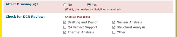

I have two tables (#q7 and #q85 are the Table IDs for the Affected Docs and New Docs tables). First, let me provide a little history. When a user checks the "Yes" radio button, it checks the QA Project Support box and disables it so it cannot be changed. This function is working nicely:

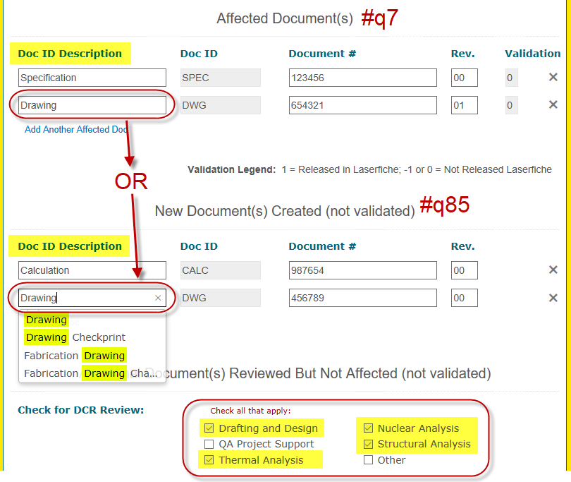

Now for my issue. Using these same two tables, if docIDDescription = Drawing (not Drawing Checkprint, Fabrication Drawing, or Fabrication Drawing Checkprint) in either of these two tables, I need to check the "discipline" boxes and disable them:
Here's what I have so far, but it's not working:

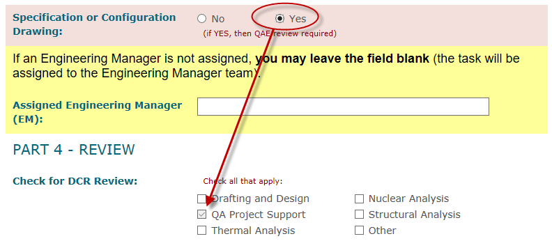

OK, decided to use the same method used on "specification".  I set up a Yes/No radio button. If “Yes” is chosen, 4 checkboxes are checked and disabled.
Got that working no problem. Thanks for the feedback earlier.

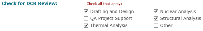

For the q7 table, it checked my boxes (yay) but didn't disable them (almost like with went with the "else" too):
As long as q85 had "drawing" in the Doc ID Desc, it worked:
Gives me hope!
