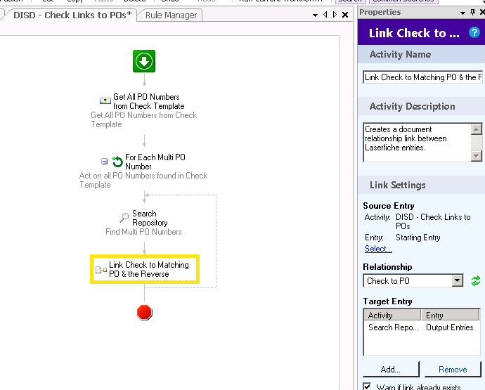

Hi, I'm trying to create links from a Check file to a PO file using Workflow. Checks can have multi-POs, and checks have a multi-value field for PO numbers.  I am using a For Each Value activity. The workflow works for the first value only. What am I missing? What information do you need to help? Thanks.
replied on July 17, 2019
You need two loops. You need a "for each value" to handle each PO number in the multi-value field, but you also need a For Each Entry loop to update every result from the search.
The way you have it now, it would work for multiple values in the multi value field of the starting document, but it is only touching the first result of your search activity.
OK. So Start another loop after the search repository activity?
Yes. Set the "For Each Entry" loop to use the results of the search, then put your link activity inside that loop and target the For Each Entry > Current Entry.
