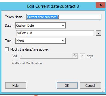

replied on July 16, 2019
HI Molly,
Thank you so much for your reply.  I am looking at the date Token Calculator activity and I am wondering if I could use the last modified date instead of the creation date?  Is that possible?  Also can you look at my data token box attached to see if I am on the right track?
I really appreciate your help!
Jen
That's not how Date Token Calculator works. Adding and subtracting days is done in the bottom section under "modify the date/time above".

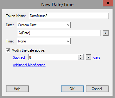

Hi Jennifer,
That's only going to use the current date (of when the Workflow runs). In order to use a date that's related to the document, you would need to find it first.
The token I would use is configured below:
