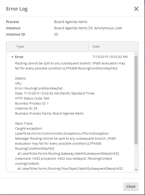

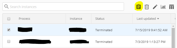

More information about the type of error would be needed to identify the issue. Go to the Monitoring page, select the terminated instance, and click the "clipboard" icon to get the error details.
replied on July 15, 2019
Hi Jason,
This is what I found.
Thank you,
Manny

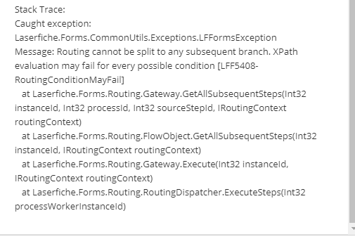

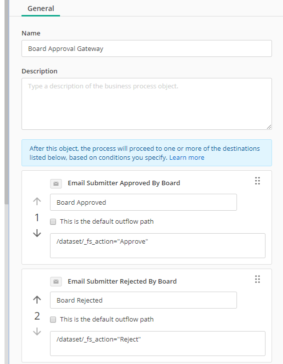

So based on that, it looks like your conditions are not being evaluated how you expected. First, I would always set a default path so you always have somewhere to go. Second, I would check the button values in the approval tasks to make sure they actually match up with the values in the condition.
replied on July 16, 2019
I just set it to Default to the Approved.
I will wait and see what happens.

I tried recreating the issue but I think by adding the Default Outflow, it might have fixed it.
