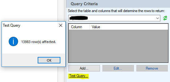

replied on July 11, 2019
Thanks, Jason.
When I do a test with nothing in the value, I'm getting zero results ("0 rows affected).
My table has only one row and one column; just a spot for one number.  My form's lookup connection is working and is pulling that one number into the form correctly.  So if Forms can see it, workflow should be able to as well.  Actually, it does see it.  I tested it by entering the Query Criteria with the number that is currently there and in that case, I get "1 row affected" during my test.  So it is finding the target row and the value.  I just can't get it to pull any number.
Any other thoughts?
Ahh, wait a minute!  You mean to not even have a line in there.  I deleted entirely and ran another test and got "1 row affected"!  Thanks, Jason!

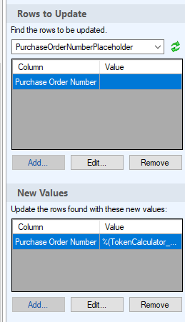

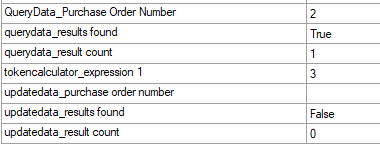

replied on July 11, 2019 • Show version history
Okay, now it's not updating!  Any thoughts on this one?
It's not updating because nothing in the table matches your "Rows to Update" criteria. The way you have it configured, it is looking for a blank value for Purchase Order Number.
Basically, it is the same problem as before. Either remove the criteria entirely, or set the "Value" equal to the Purchase Order Number returned from the initial query.

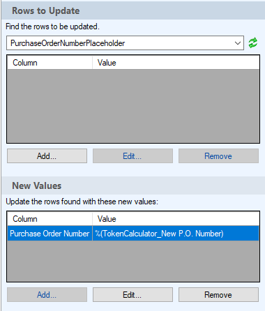

Right!  Remove everything.  Works! Thanks!

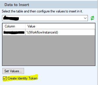

If you don't mind having multiple rows in your table, you could do the following.
  1. Create the table with at least two columns
    • An "ID" column using SQL "IDENTITY"
    • One or more columns for some other data (date, instance id, etc.)
  2. Instead of querying and updating the table, use an Insert Data activity, and check the box for "Create Identity Token"
  3. Use the Identity Token as your PO
For the SQL table
CREATE TABLE [dbo].[PurchaseOrder](
	[PurchaseOrderNumber] [int] PRIMARY KEY IDENTITY(1,1),
	[WorkflowInstance] [uniqueidentifier] NOT NULL
PRIMARY KEY requires "PurchaseOrderNumber" to be unique
IDENTITY(1,1) tells SQL to start at 1 and auto-increment by 1
What this does is create a table that automatically increments the "Identity" column when a new row is added and by default cannot be set manually.
In Workflow,
Here, you are inserting data into your other column. The IDENTITY property will automatically assign the "next" unique value (don't try to set it manually).
The "Create Identity Token" will return the auto-generated value as a token that you can then use in the workflow as your Purchase Order Number.
By doing this, you:
  1. Reduce it down to 1 query per workflow
  2. Don't have to "manually" generate a unique ID
  3. Allow SQL to take care of "uniqueness" and concurrent requests
If you really don't want to keep data long term, you could add a Custom Query to delete the row after you get the identity.
As long as you don't DROP or TRUNCATE the table, the IDENTITY will continue to increment even if you delete the table contents.
