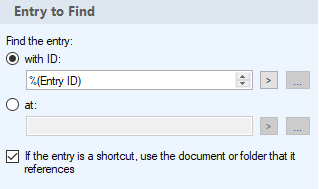

In some cases you would want to act on the Shortcut itself, so I think the "Starting Entry" would be the shortcut, not the associated document.
However, you can use a Find Entry activity to get the underlying document, then either reference the result of Find Entry in your workflow activities, or use it to update the "Starting Entry"
(The former may make more sense since you need to reference the shortcut for the delete activity)
Add a Find Entry as the first step, set it to use the Starting Entry ID token, and check the box telling it to get the referenced document instead of the shortcut.
One thing to note is that if the Shortcut has the same name and you move the Document before deleting the shortcut, it will automatically rename the original with a (2) at the end.
