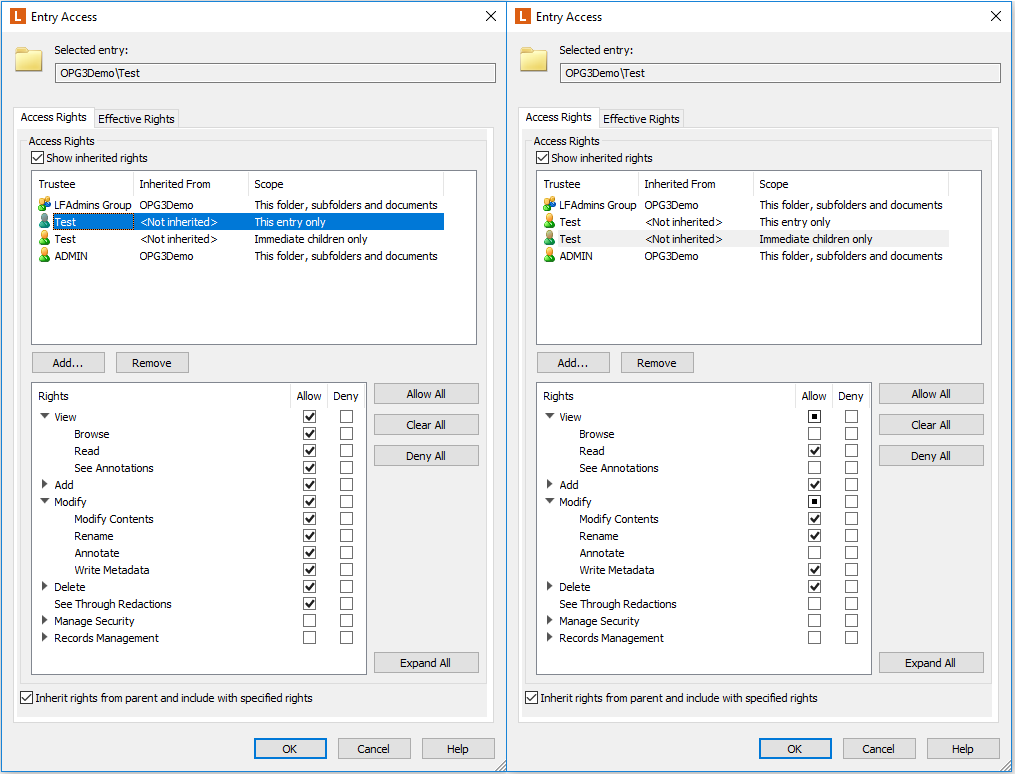

I found that with the This Entry Only scope, it does throw the error upon create.  The entry is created but no pages or metadata are added and you can not see the entry because you do not have rights to it.
You can either add another entry access for the same group/user with a scope of Immediate Children Only (for Folders and Documents) or Documents That Are Immediate Children Only (for Documents only).  Or you can change the original scope from This Entry Only to This Folder and Its Immediate Children.  It all depends on what you are trying to accomplish.

It has been a long time since I set this type of configuration up.  In LF 7 and previous, we always made a recycle folder where users could drop entries in but could not view anything inside.  It always needed to have 2 scopes to accomplish.  The first was for this entry only and gave them the ability to see the folder and create/modify entries.  The second was on the children to again grant the create/modify but not the view/browse.
If you try to add a document to the folder as the restricted user with just a scope of this entry only, and then look in the folder as the admin, you will see that the entry was created, but it has none of the metadata or pages.  This is where the child scope comes into play.  If they do not have rights to the child, they can not complete the create/move activity.

Here are my settings:
