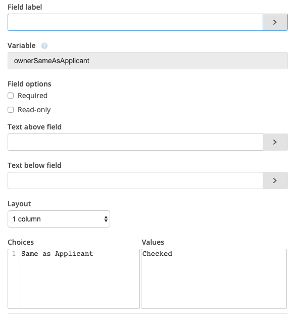

I've been searching the forums and keep finding solutions that are kind of like what I want to do but not exactly. I want to copy a single field ("applicantPhone") to another field ("ownerPhone") if a checkbox ("ownerSameAsApplicant") is checked.
This is the calculation I'm trying to use based on what I've found on other threads:
=IF(ownerSameAsApplicant=Checked,applicantPhone,"")
I get an error saying that ownerSameAsApplicant is an invalid variable. I've also tried:
=IF(ownerSameAsApplicant="Checked",applicantPhone,"")
Here is the ownerSameAsApplicant info

I was actually able to figure this out using a Checkbox! You should be able to use the below function on your field:
=IF(ownerSameAsApplicant.Checked,applicantPhone,"")
Let me know how that works for you!
