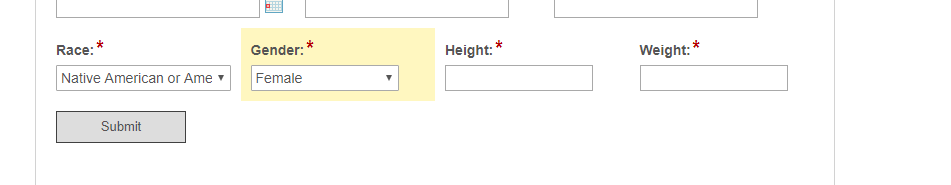

I am trying to have some of my fields displayed with four on a line. The first blank for Race I need to be a little bigger so that it doesn't cut off the text when storing it. I have set it to a large field while the other I have set as a medium field.
Do I need two css lines for medium and Large? when i change the width it changes all of them instead of just changing the one field that I need large. Is there a way for me to just make that field bigger?

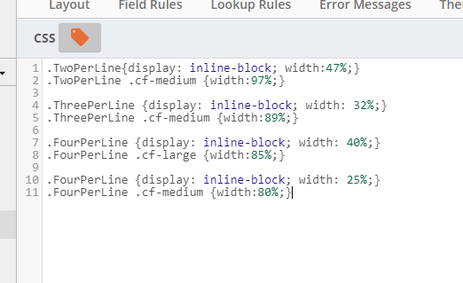

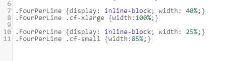

replied on June 26, 2019
I thought that is what I had.. I am very new to CSS, so I am very unfamiliar with terms but the second picture shows what I currently have with the two fourperline classes.
replied on June 26, 2019 Show version history
What you actually have is two levels of CSS
.FourPerLine applies to the top-level containers with that class
.FourPerLine .cf-____ applies to the matching child within the matching container
What you need is different sizes for the top-level containers, so you can't use the same .FourPerLine for all four.
With what you have in your screenshot above, the 40% for .FourPerLine is actually being overridden by the 25% because they apply to the same elements.
