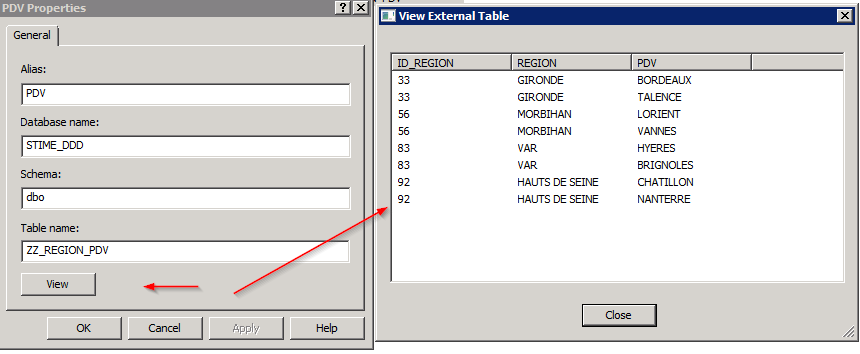

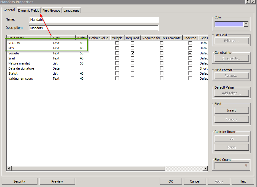

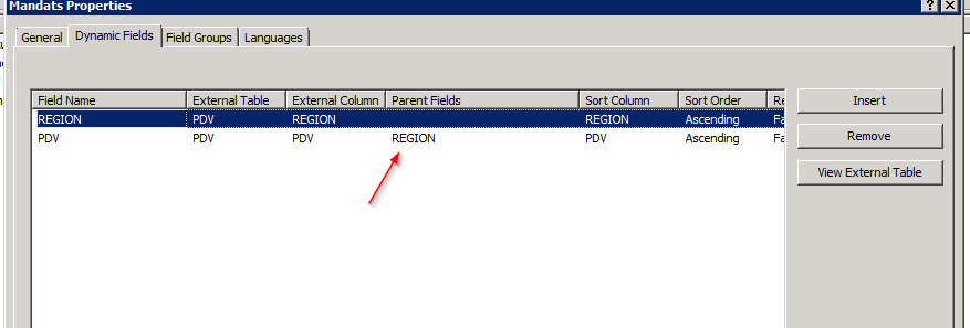

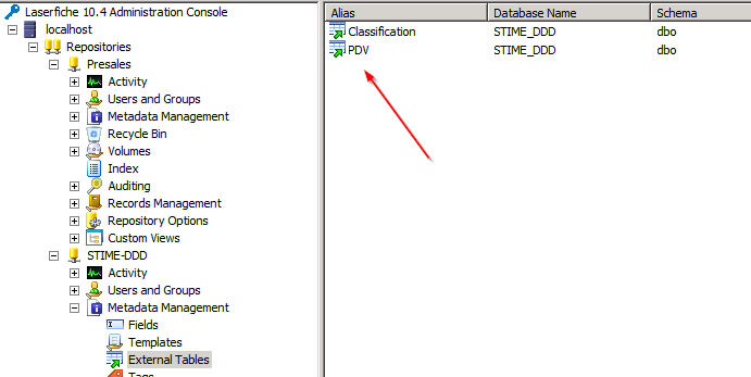

Create an external table, then dynamic fields. see the examples below.
