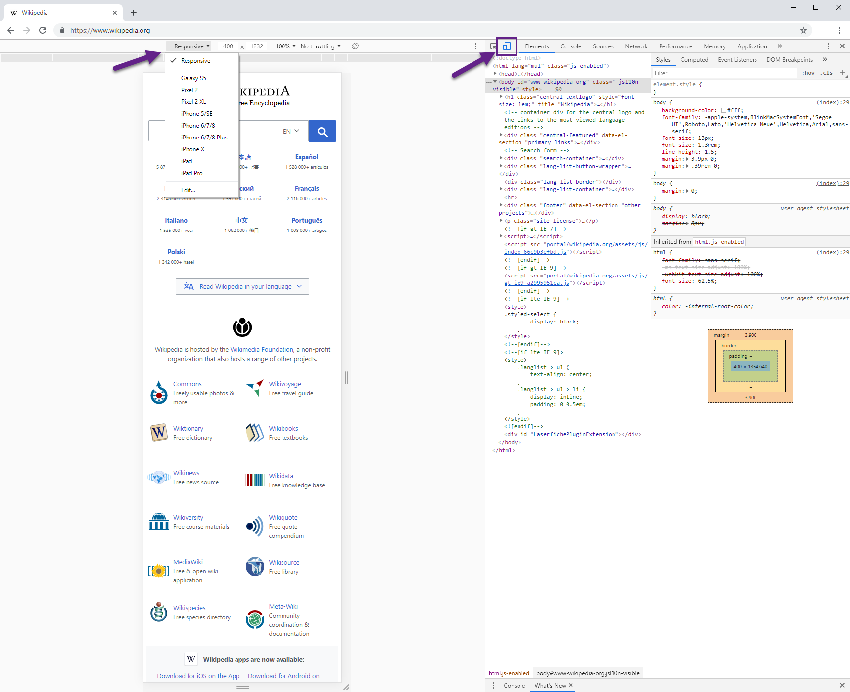

You can also try simulating different mobile devices in Chrome Dev tools. Worth reading the link below to understand what it does and does not emulate.
https://developers.google.com/web/tools/chrome-devtools/device-mode/
