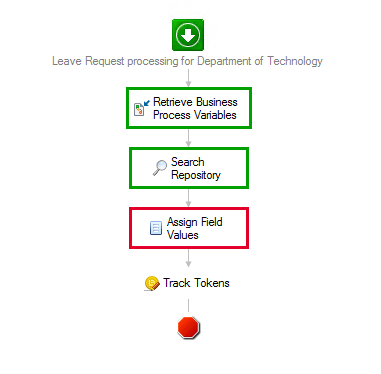

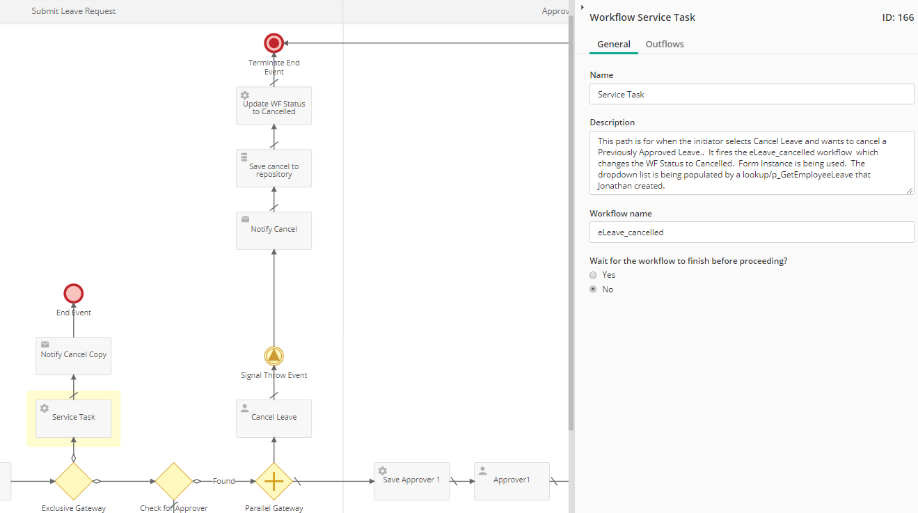

I have a leave form that fires off a workflow that is not assigning a value to a field (WF Status set to Cancelled)
We are on Laserfiche Forms Professional Version 10.3.1.690
Here are the screenshots from the process.

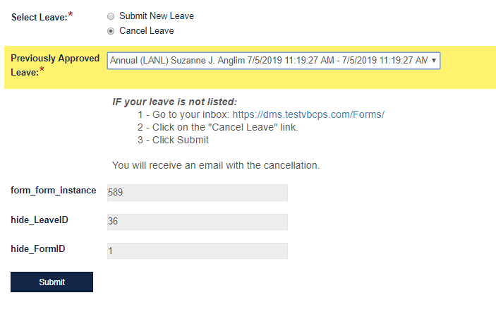

Initiator submits Cancel Leave form:

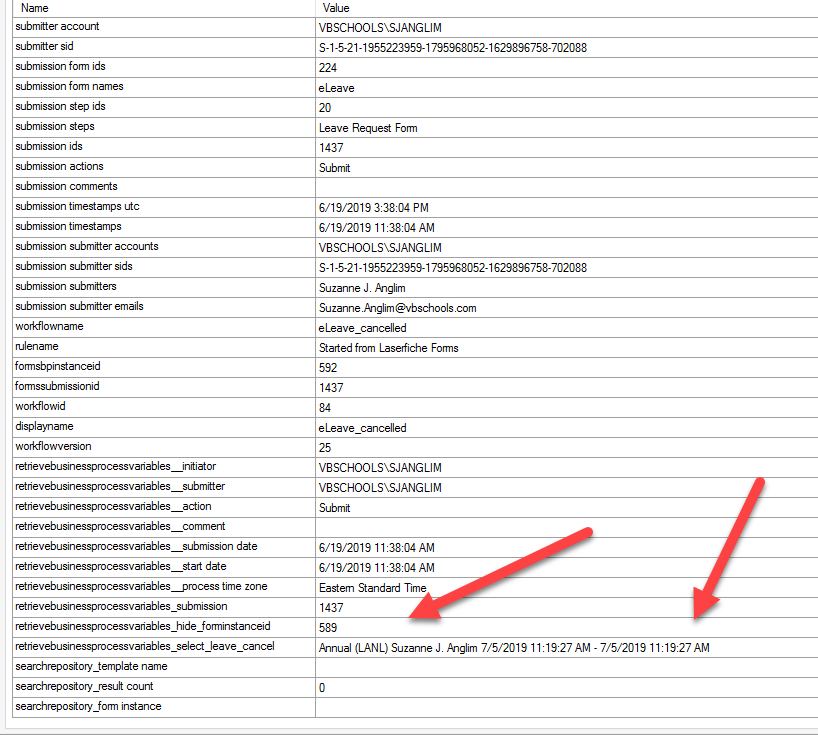

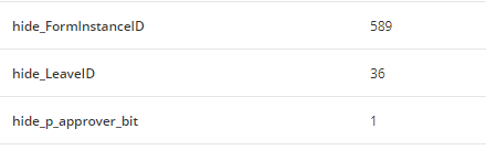

The form instance is coming from a stored procedure of all approved leave.  So I do a look up on the form name, and return the FormID, LeaveID, and form_instance.  This is all working and data has been verified.
The form is showing the correct Form Instance as well in the task / variables panel

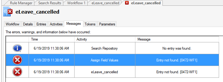

Here is the error:

Thanks for the reply Miruna.

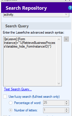

A numeric value that the form is passing.
Found the issue with some help.  I didn't have the parameter wrapped in the syntax
THANK YOU again for all you do for me and others!!  You rock!!

I'm guessing you're trying to set the field value on the result(s) of the search? Since that returned no results, workflow worked as designed. You can wrap the Assign Field Values activity in a conditional sequence that checks whether results were returned, but that would only keep the workflow from terminating, not solve the underlying problem.
What are you searching for?
