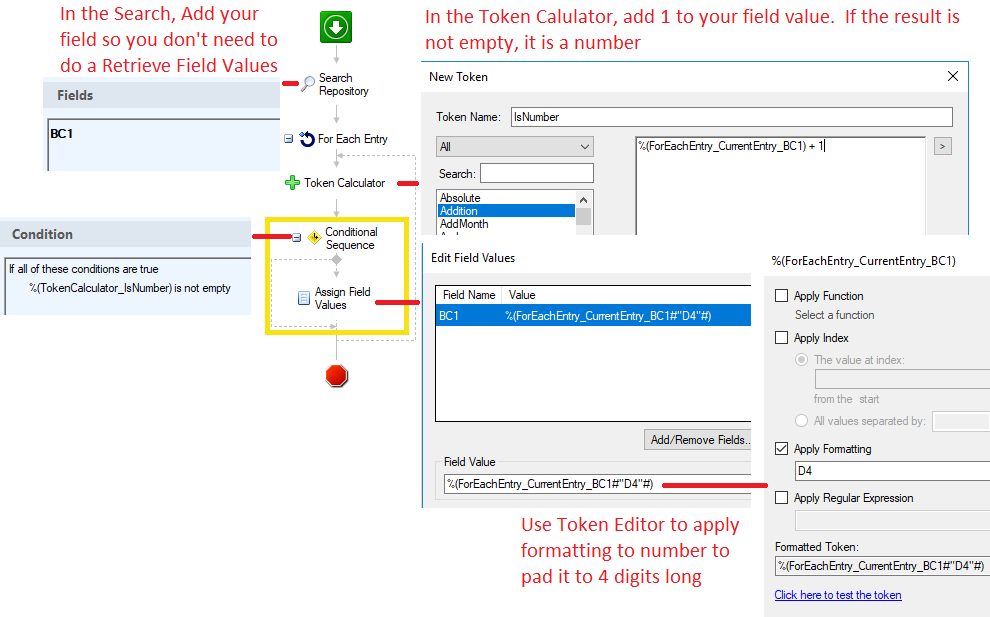

replied on June 19, 2019 • Show version history
Have you thought about using standard Workflow tools?
As long as your search can find the documents that you need to update, this will run and update/pad the field values.
I used a search that only returned documents with a 3 character value in the field:
{[]:[BC1]="???"} & {LF:Name="*", Type="D"}
