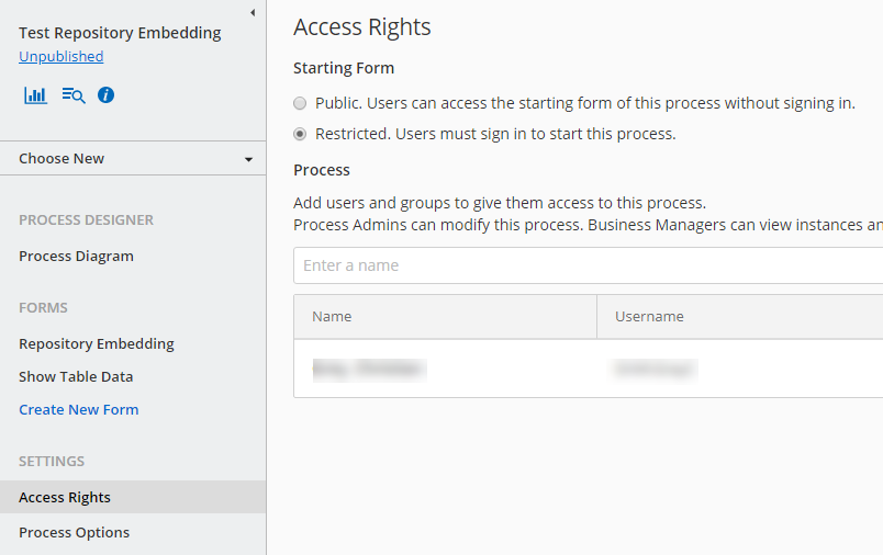

First you must have a license for the Forms Public Portal.  If you do, when you set the Access Rights in your form, click on the Public option.

Alright, I don't seem to have those options so I will have to see what licensing we have and what we are missing. Thanks!
