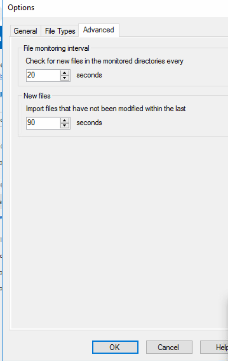

Hi Eric,
I don't remember specifically what the solution was here, but we've fixed similar issues to this by increasing the amount of time that passes before Import Agent will attempt to bring a document into Laserfiche. You can do this by opening Import Agent Config, choosing Profile in the menu bar at the top, and clicking Options. Then head to the Advanced tab and change the time under New Files. This may have been the fix for us - I just don't recall.
