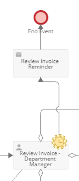

We have a process that had some intermediate timers attached to user tasks that sent email reminders:
We decided against this, and removed the intermediate timer events.

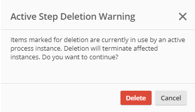

We noted that sometimes, Forms warns you if you try to delete an activity:
However, for the intermediate timer events, we did NOT receive this warning. And yet, the instances are still terminating.

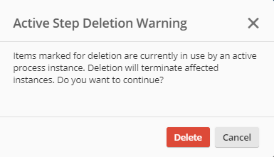

Has anyone here seen the notification @████████ shows above in versions later than 10.2.1? This is regarding the deletion of an activity, timer, throw, catch, etc..
Here it is:
Thanks
replied on October 10, 2019
Yes. This happens if you try to delete a TASK that is currently assigned to someone. There is no warning if you delete a TIMER event from a task.

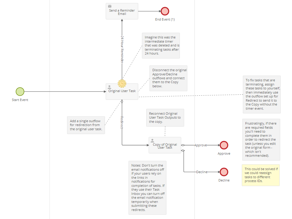

My solution:

Hi @████████
In production it would look slightly different. I would have routed all "new" submissions (coming via the Start Event in the example) away from the troubled "Original User Task" and straight to the new Task (Copy of Original User Task).
That way should any new traffic arrive while I'm working on migrating the the tasks away from the troubled task, they will be managed correctly / as normal.
Don't get me started on how these workarounds impact reporting. Haha.

I'm still not sure how to route the flow past the affected timer since my timer task routed back to the task itself, not to another task and end event.
