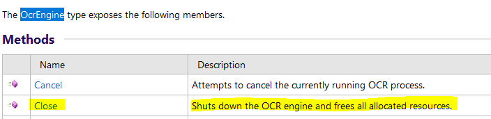

Are you closing down the OCR engine when the process is complete?
OCREngine instances can be reused, so they don't close down on their own.

Shouldn't the using block close and release the OCR Engine?
using (OcrEngine ocrEngine = OcrEngine.LoadEngine())
replied on June 7, 2019 Show version history
Using statements will handle garbage collection activities like calling Dispose on a document object, but I don't think they would execute a close method.
The object reference would be disposed of, but the engine may still exist. Kind of like exiting a remote desktop session without logging out.
Something similar happens when you create a repository session in a using statement; the reference will be gone, but the connection remains active if you don't actually close it.
(We had this problem with a vendor making repository connections but never disconnecting so the connections remained active until the server timed them out for inactivity)
According to Microsoft using statements only relate to IDisposable, which is about releasing memory/resources, not shutting down connections and such.
"Using" is basically just a try-catch-finally and .Dispose() rolled into one block.
