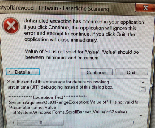

Hello,
I am getting a Laserfiche error that is saying
"Unhandled exception has occured in your application. If you continue, the application will ignore this error and attempt to continue. if you click Quit, the application will close immediately.    Value of '-1' is not valid for 'Value'. 'Value' should be between 'minimum' and 'maximum'."
Attached is a screenshot of this error. This error pops up when a user scans into certain folders and not all folders. I have tried to uninstall and then re-install laserfiche but this did not work. Any advice would be greatly appreciated.
LFTwain issue.png (553.96 KB)

We've found this is most usually related to a user attribute. If it works for one user, but not another, then the user may have an invalid attribute. Clearing them out works in that case.

We are seeing the exact same issue.   We have uninstalled and reinstalled Laserfiche 10.4, uninstalled and reinstalled .Net, tested with different LF users.  Still get the error.  What is strange is that when creating a new file (it  works fine), but when and adding to an existing one the error pops up.  In fact, you don't even need to scan.  Just open the scanning and then try to close it, then the error is thrown.
Any ideas?

Hi Melissa,
My advice would be to raise a support case with your VAR/Laserfiche using the scanner on the supported scanner list as an example. Laserfiche will likely ask you to produce logs for the crash using ProcDump or something similar. You might be able to speed up a resolution by providing this in advance.
Details on how to use procdump are here - https://support.laserfiche.com/kb/1012603/generating-memory-dumps
Other things to try, is things like temporarily disabled any anti-virus software to see if that is causing you issues, and try logging onto the affected machines as different windows users. Also try turning off UAC if you haven't done already.
Hope this helps!
