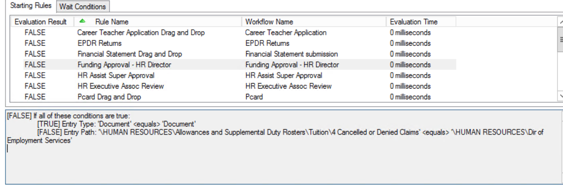

replied on June 6, 2019
Based on that screenshot, the Entry Path condition of your rule is not being met.
Are these documents in a different folder from the others?

So does the Tracer only log Errors or False conditions?
I also checked the document and the template is correct and Complete is selected.  Looks like the other docs that are being processed.
The tracer logs all rule evaluations made for each entry event, but for optimal performance it stops evaluating a rule/group as soon as it find that the conditions cannot be met.

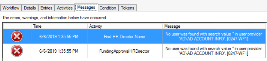

Wait one!!!  There is an error on the workflow designer search results.
Let me see what's happening.  I'll keep you posted.

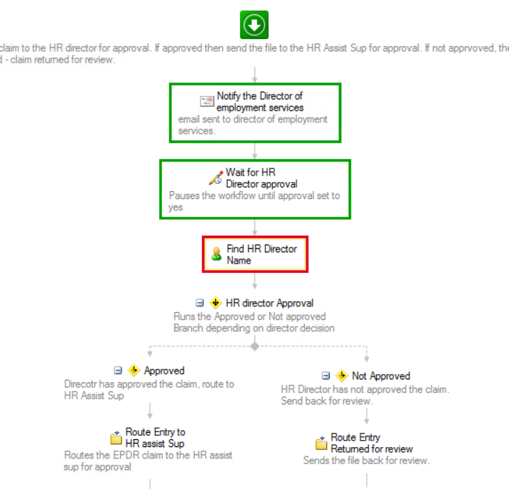

Any idea why this may have failed (attachment) when it is working on all other docs...  Network hiccup?

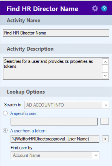

It looks like no value is being provided for the search parameter. In the workflow configuration, is it set to "a user from a token" and if so, what token is being used?
replied on June 6, 2019 • Show version history
Populating from AD
I634962 - 4.PNG (154.56 KB)

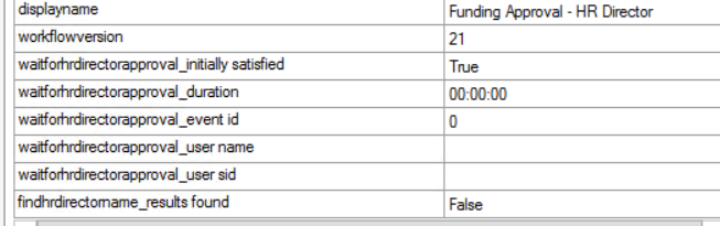

Click over to the Tokens tab in the instance details and check the value of that token. Since the instance terminated, newer versions of Workflow automatically track all token value at that point.
Now that's an awesome new feature!
Nice!
Blank :(
Can you tell me any reason why it didn't get populated then and now when I brought the files back in...  The directory has not changed and it is working on other docs.
My guess would be that because the wait condition was already satisfied, it didn't detect who made the change and therefore couldn't obtain the user name.
I would set approval back to "No" then move it back out/in, and have a user who is supposed to do the approval set it to yes to satisfy the wait condition.

It's that "initially satisfied" part. This document landed in the folder with everything in place to satisfy the wait conditions. So there was no user changing it, it passed right through.
