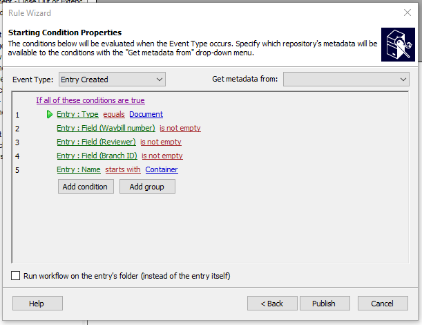

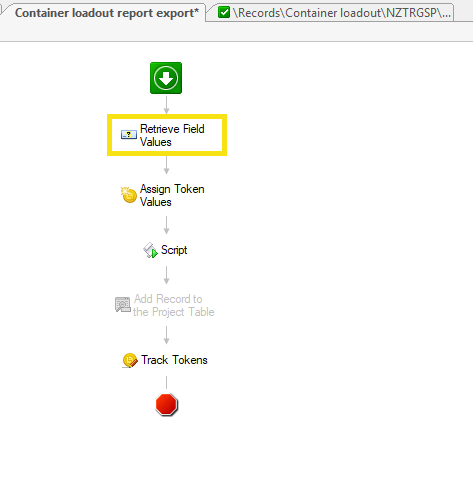

Hello,
We have a process created in LF Forms when we generate some forms and the last one is saved to the repository. Then, the idea is to save this form in a database to then generate an email that is sent to a customer with a link to a "dropbox" where the document is available (it is an internal process so we cannot modify it).
To do this last step, we have designed a workflow in Workflow designer, when the starting rule targets the document (by using the conditions in the screenshot attached). I have also attached a screenshot of the worflow.
When I was running the process from LF forms, as I initially had a Service Task that was targeting this workflow, it was running twice (from Worflow designer and from LF Forms). But the instance from LF Forms was terminated with an error message "No entry was specified".
I was thinking of modifying my process by using the "Started by Laserfiche forms" option to have the workflow service task running from the form process modeler. I have not really sure how to do it, as it  was not running correctly when part of the forms process. When should I specify the form process that starts the workflow ?
Thanks for any help or suggestions.
replied on June 5, 2019
This works as designed if you are starting the workflow both from Forms and from the document creation.
Because Forms doesn't have a document ID and can't pass it to Workflow, that instance doesn't know what document you want it to work on.
You can remove the part where Forms triggers this workflow and let the document creation start it.
