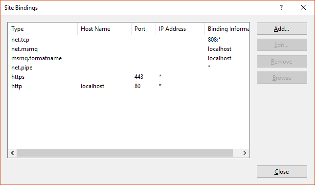

We've just set up Workflow at a clients site and we've tried to use Workflow Web Services, however I've noticed this won't run without the http protocol enabled in IIS? If I have both the http and https protocols bound in IIS then Workflow Web Services work perfectly:

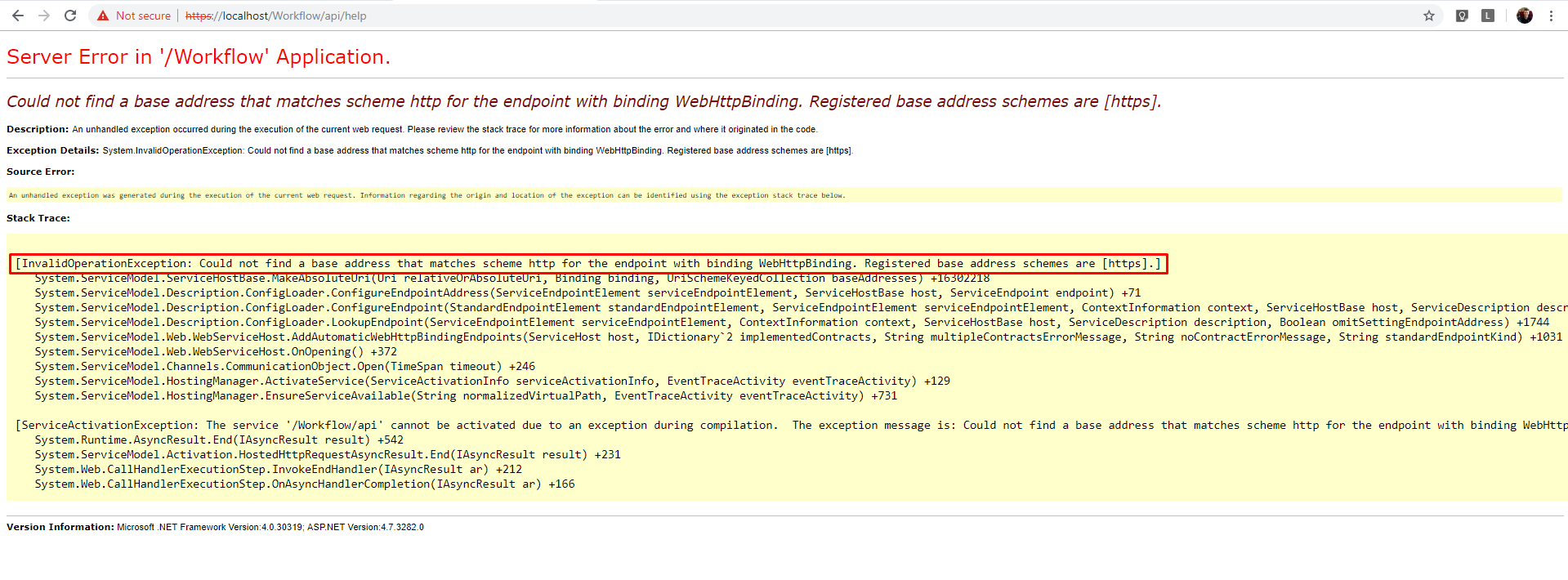

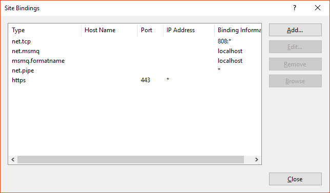

However if I remove the the http protocol from the bindings menu I get the following:
Just to confirm, the issue is seen with this configuation:
And the working configuration is:

It needs port 80 to have a binding in IIS. You can block all traffic to it though.
