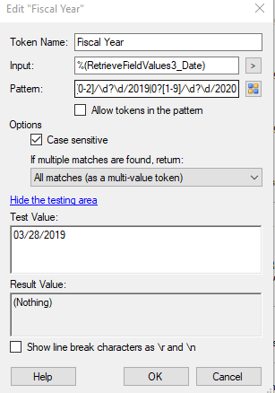

asked on May 29, 2019
Is it possible to get a Pattern Match for the Fiscal year instead of the Calendar year?
I found this Pattern: 1[0-2]/\d?\d/2019|0?[1-9]/\d?\d/2020, but it returns a Result Value of (Nothing.)
Currently using this Pattern Matching:
Input:%(RetrieveFieldValues3_Date)
Pattern: \d?\d?/\d?\d?/(\d?\d?\d?\d?)
Fiscal Year.PNG (12.44 KB)
replied on May 29, 2019
What makes a fiscal year date different than a standard date? The pattern you have there won't work because the input contains the year 2019, and the pattern is looking for 2020.
Can you explain what specifically you need to be able to find?

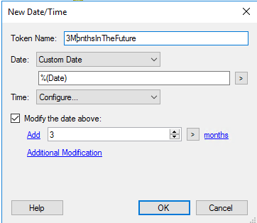

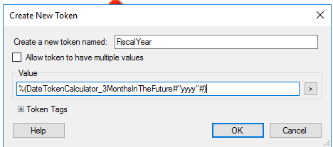

Pattern matching only extracts information from the existing data. It cannot add years that are not there.
But, it looks like you're fiscal year is offset by 3 months from calendar years. I think you can do this with Token Calculator. If you add 3 months to any date and then format it to get just the year, you'll get the fiscal year.
For ex, anything before 10/1/2019 will still be in 2019 when you add 3 months, which will give you 2019 as the year. Anything after 10/1/2019 will be in 2020 when you add 3 months, so when you format it, you'll get year 2020.
