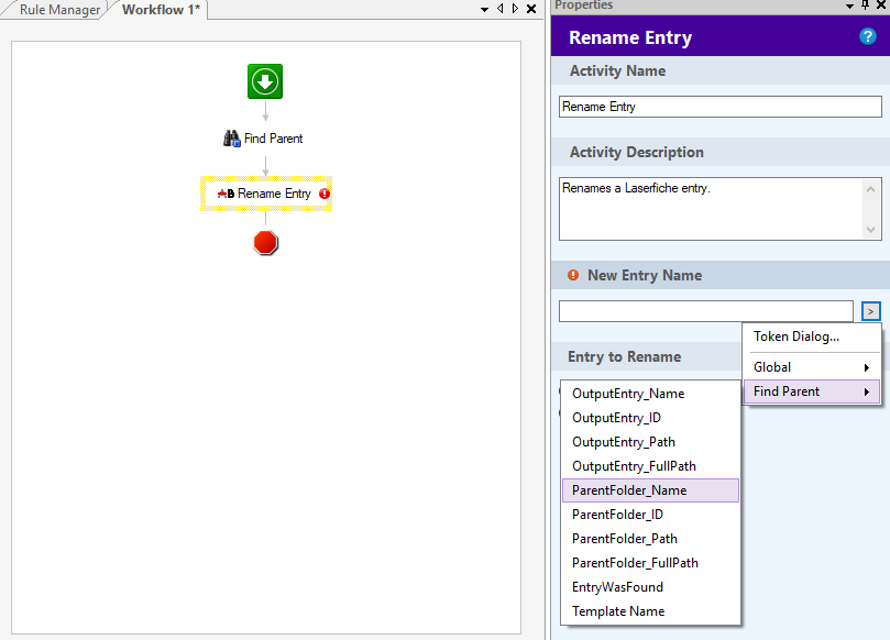

replied on May 28, 2019
As long as you have access to the appropriate token, you can use the Rename Entry activity to use it to rename the appropriate entry.
Click the chevron button next to the field, and the source of the tokens will appear in the menu, or you can use the Token Dialog to select the one you want.

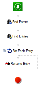

replied on May 29, 2019
Ah, the original post used "document" in the singular. Assuming that you can get the parent entry id, you can use the Find Entries activity to get a list of all of the entries contained within that parent entry. From there, you can loop over all of the children and rename them.

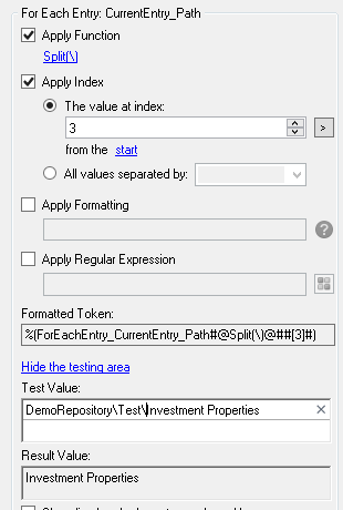

If you get the current entry path and in the token dialog you could use the Split function to get your folder name. I think that would work.
