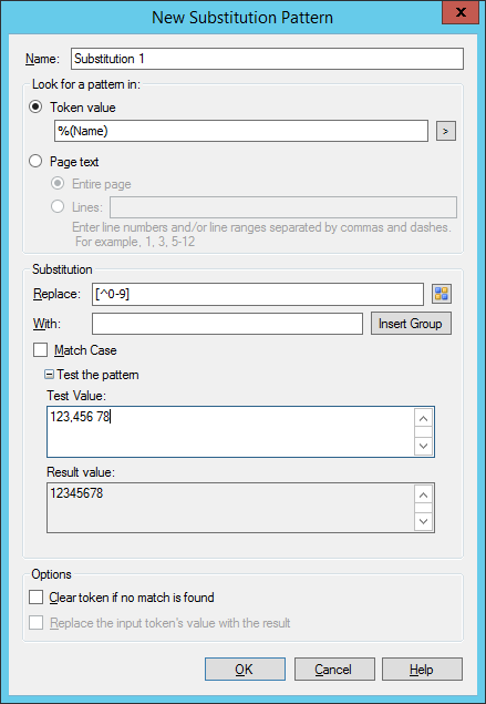

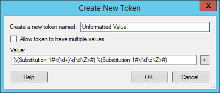

Unfortunately, if OCR does not correctly identify all of the characters, you won't be able to repair that easily. However, you might be able to use the Substitution process to remove all of the non-digit characters, such as commas and spaces...
Then break it apart, and put it back in with the decimal where it should be.

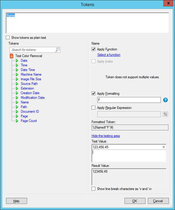

If the original string matches the format you've labeled "OCR value standard" then you can use the Fixed Point format specifier to strip out the commas.
