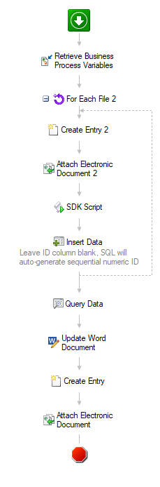

Here is the workflow that I am using while trying to prove concept so it doesn't have all the complications of the actual use case. I am grabbing the image file uploaded from the form, saving it to the repository, then running the script (posted below) and attempting to create the document.
Here is the script. I don't 'speak' C# so I didn't write this - it was put together by someone else from our team. But if there is anything wrong, I can certainly update it.

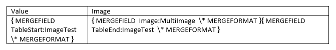

My SQL column containing the base64 string is configured as nvarchar(max). I also took a screenshot showing how my Word table is formatted. The 'Value' column has been left blank intentionally for testing.
