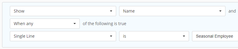

You don't set the Calculation equal to "Seasonal Employee"
You set the Calculation equal to your drop down variable, and you use the Single Line field for the Field Rule, not the drop down.
In the Field Rule, you can manually enter "Seasonal Employee" when you have it pointed at the Single Line.
Basically, you can't do what you want with the drop down directly, so the Single Line with the Calculation gives you an indirect way to reference the drop down value.
See below (use the > button to select the actual variable name for your drop down)
replied on May 22, 2019 • Show version history
The workaround for using Field Rules is as follows.
  1. Create a hidden Single Line field
  2. In the advanced tab of the field
    • Add a Calculation that sets it equal to your dropdown variable
  3. In the Field rules, set it to Hide/Show based on the value of the hidden Single Line
    • Manually enter the "trigger" value (i.e., "Seasonal Employee")
If you use JavaScript, you would need to hard-code the value anyway; this approach requires less customization and still uses the built-in hide/show functionality.

Question 2 - so in the Field Rules, I would be telling it to Show the Name field only if ...  ... no, I still can't tell it to show the name field only if the drop down field is Seasonal Employee.  Um, maybe this part is dependent on the Calculation?

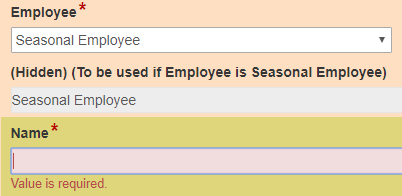

I need the submitter to be able to tell me that the Employee (drop down look up) is a Seasonal Employee instead of picking a regular employee name out of the Look Up list and then I want to provide him with an additional field (Name field, single line) where he can manually type in the Name of the seasonal (temporary) employee.

Thanks, Jason!  I got it working.  I didn't realize the hidden single line field you were talking about wasn't the same field I was using for the Name field.  Now I have two hidden fields.  One that will ALWAYS remain hidden and just populates the users choice in the drop down field.  Then, the hidden Name field will only show if the choice that ends up in the always hidden field turns out to be Seasonal Employee.
It works!  Thanks so much!
