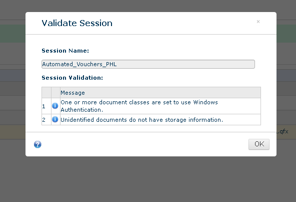

I have a QF session that I am trying to schedule through the agent. The session will not validate, but I believe the settings are correct.

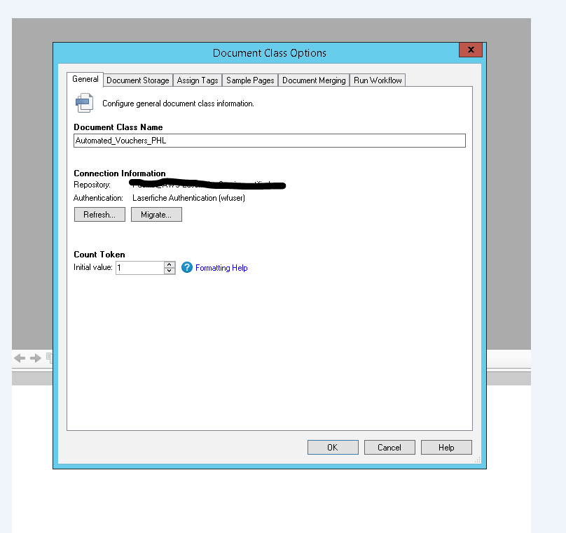

It says session requires windows auth, but I believe it is set to Laserfiche Auth

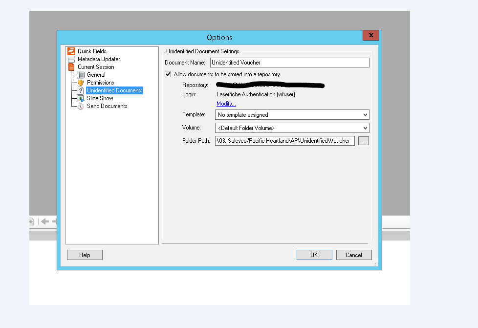

And it says unidentified docs do not have storage information, but that has been configure also.

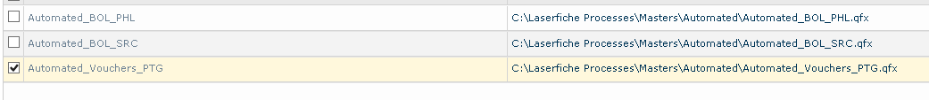

The session is stored, and referenced from the same spot as my other agent sessions. Will see if I can run anyway.
Any way to verify, for sure, I have same session. Other than the path to the file itself?
