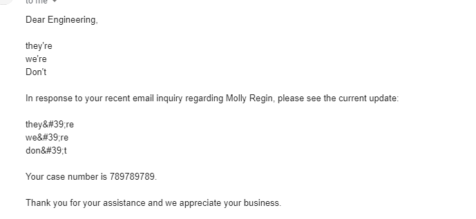

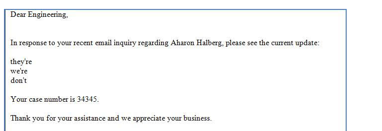

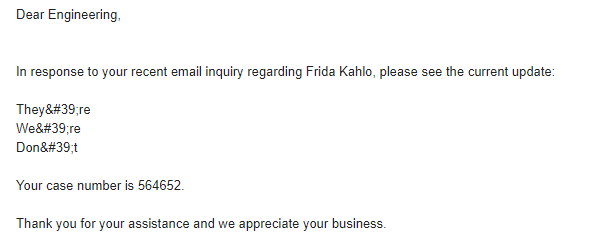

I have a WF that uses the Email activity. When I test this it sends me an email with odd characters replacing the apostrophes in the email. I started a support case with our vendor and when they get the email it looks fine to them. I attached the two versions. Does anyone know what could be causing this? We use Google.

How do you have your Workflow Email activity configured? It looks like the email you're seeing is taking the apostrophe code as a literal string.
Special characters are encoded for things like URLs and HTML. Email uses HTML type encoding and ' is one way to encode the single quote/apostrophe character.
More information is needed, but it could be a problem with either the formatting or the decoding.

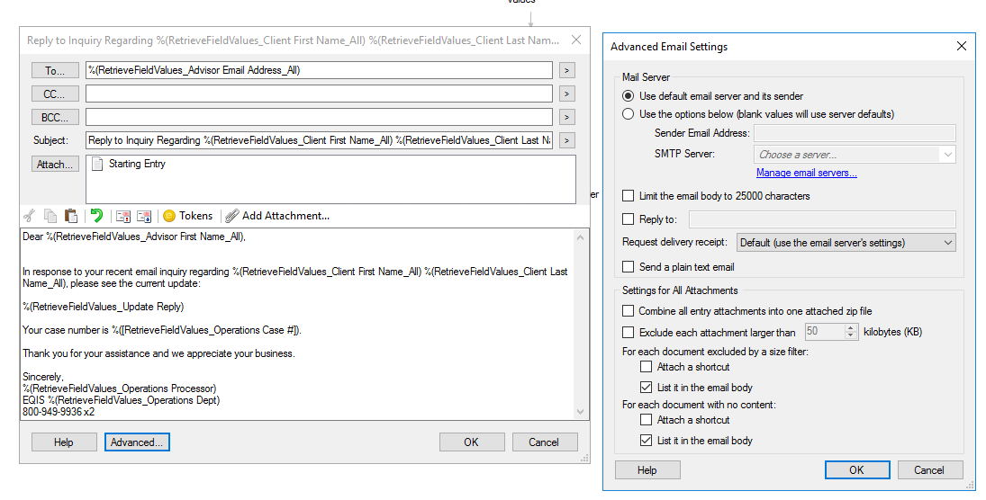

Thanks, here is a shot of how we have it configured
replied on May 13, 2019
Okay so it looks like the text having issues is the Update Reply field value.
As a test, what do you see if you put apostrophe's anywhere in the static text? That would help determine if it affecting the entire email or just the token text.

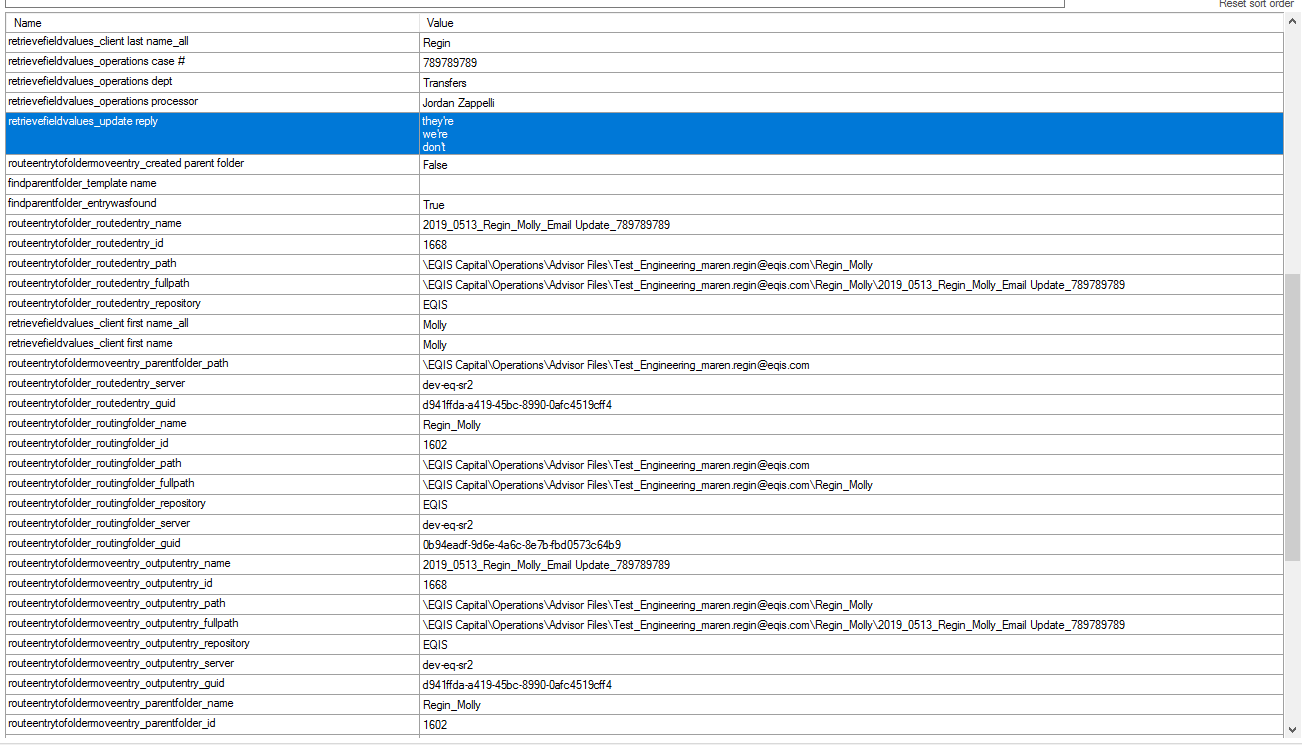

Are you tracking the tokens? It would help to see exactly what value Workflow is getting from the Retrieve Field Values activity.
I am tracking tokens! Yay! I'm kind of a newbie though.... Where would I find these tokens that I tracked? lol
If you open the workflow instance from the search results, there will be a tab labeled "Tokens" which will have any tracked token values.
replied on May 14, 2019
You're awesome! Thank you! I did find the token for the the Retrieve Field Values activity on this guy- it looks normal? Attaching screenshot!
