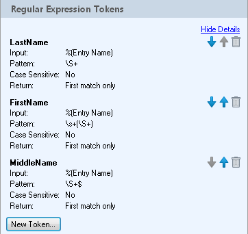

replied on May 9, 2019 • Show version history
Try this:
Using \S+ will return things like full hyphenated last names, where \w+ will only return the part of the name before the hyphen.
FirstName \s+[\S+]  only returns first character of first name
John -
Those characters are parentheses, not brackets:
\s+(\S+)
