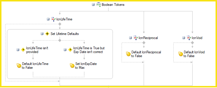

My concern here is with the bit columns. I have a Conditional Parallel with a branch for each, to have a default "false" value set just in case an empty value is provided to the workflow (or some other unforeseen issue happens and the value isn't a True/False):

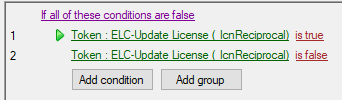

Each branch has the same conditions (the first one has some extra conditions, but those aren't relevant) - Basically, "if the value isn't true or false":

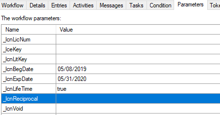

It counted an empty input parameter as true! To be clear, both runs had the same empty values for the booleans:
