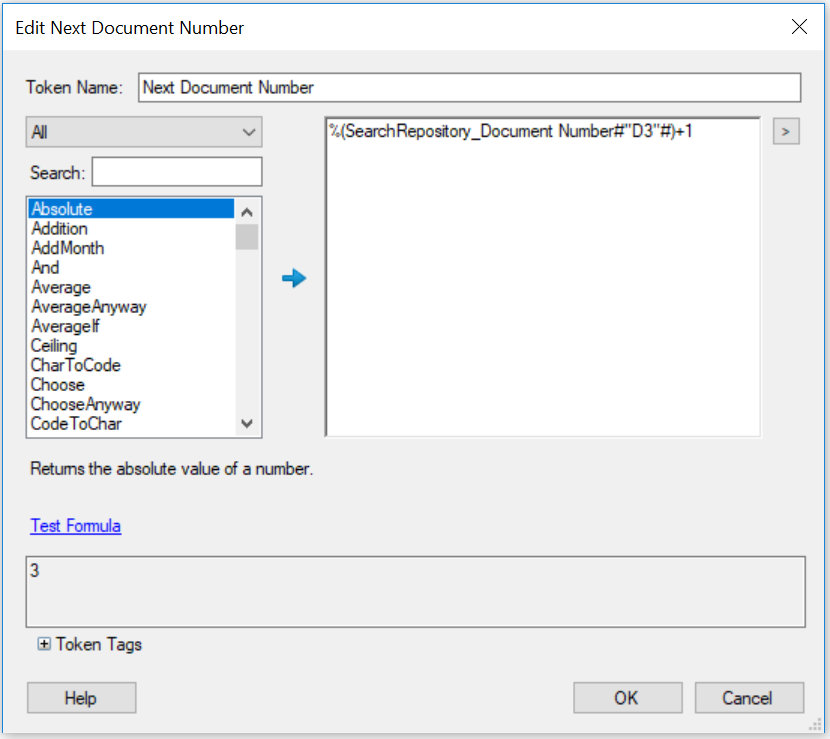

I have a metadata field which houses a document number.  As this number is used in the middle of an intelligent naming convention, we need leading 0's.
The metadata field is set up as a text field as we were unable to get the leading 0's in a number field.  The constraint we have on this field is: \d{3,} as we require it to be at least a 3 digit number, though in some cases it may be longer.
When I get the value as part of my search repository function, it seems to be dropping the leading 0's as when I put this into a token calculator to give me the next incremental number, the test returns without the leading 0's.
What can I do to either retain the leading 0's or add them back in as necessary after the token calculation?

replied on May 8, 2019
Miruna,
Thank you for your response.  I have tried this, but my test still only gives me a single digit with no leading 0's, regardless of if I type #"D3"# or #"000"#.
Any thoughts on if I am doing something wrong or if something else might work better?  Thank you.

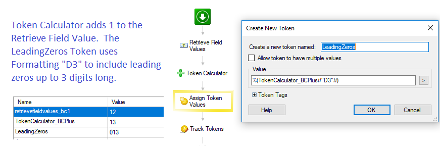

Apply the formatting to the results of the Token Calculator token.  See my post below.
You want to do the calculation first, then format. "0001" +1 doesn't mean anything as far as math goes, you want to 1 +1 first, then format the result to have leading zeros.
