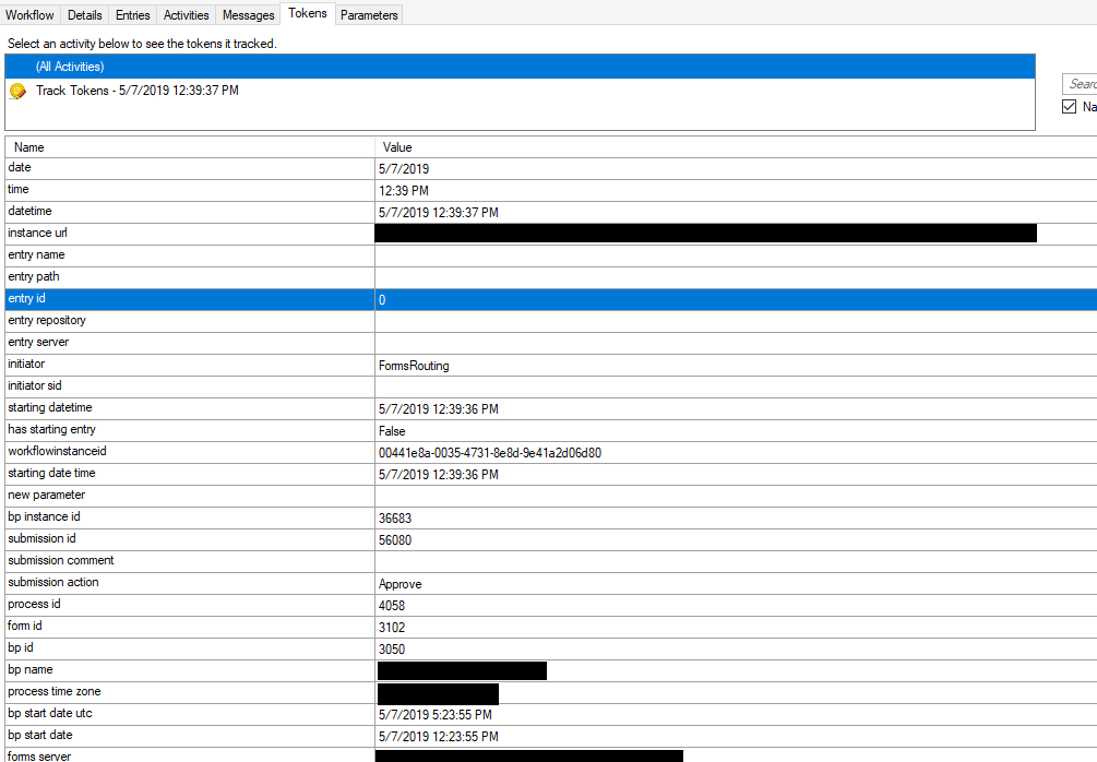

I'm running a workflow initiated by a Forms instance. Whenever my form gets to the workflow, this.BoundEntryID is -1, and I can't get a value for this statement:
DocumentInfo doc = (DocumentInfo)this.BoundEntryInfo;
Should I be accessing a different variable?

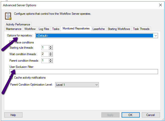

Does your starting rule have conditions to exclude the WORKFLOW user?
If not, check if this user was added to the "user exclusion filter" in the server's advanced options in the WF Admin Console

replied on May 10, 2019
This was it. So I've changed the Save task to use my profile to save documents, and everything kicked off as expected when I tested again. Thank you so much for your help!

replied on May 7, 2019
When a Forms instance starts a Workflow, there is no "Starting Entry"
The "Script's Default Entry" is the value utilized by BoundEntryInfo, so if you have it set to use "Starting Entry" (the default) there will be nothing to reference.
In order to use BoundEntryInfo in your script activity, you'll need to use a Find Entry activity to get the entry you want to work with and use that as the default entry for your script activity.
