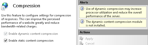

Has anyone enabled dynamic compression in IIS for use with Forms? Our configuration shows that that module is not installed. I get no search results from the online Forms documentation when searching for "dynamic compression" or "dynamic content".

I installed the dynamic content compression module and cranked it up. I could see the CPU get taxed as I tested. Unfortunately, I saw no difference in performance of my forms. Because of this, I don't plan on testing any further. No time.

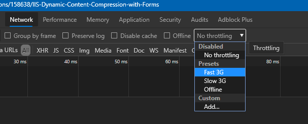

How are you defining "performance"? Dynamic compression on a local network is unlikely to have much of an impact. Where you see the most benefit is in a bandwidth constrained environment. If you don't have any users who may be coming from a slower external connection, then it probably isn't worth the CPU overhead.
You can simulate this more closely by changing the connection emulation in the network tab of the Chromium F12 tools.
